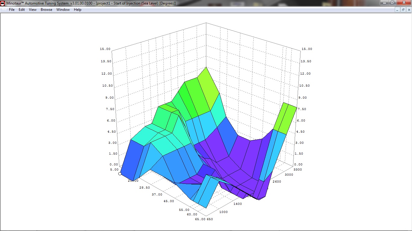

Start of injection timing?
I would think that would definitely need to be optimized due to the lack of a pilot injection. It would be nice to see stock obs vs stock SD timing tables. That may get you pointed in the right direction.

Heres a stock OBS/single shot map.

I honestly don't understand why we need different calibrations yet. As the plunger travels down it passes the relief in the barrel causing the pilot shot then finishes the injection event. Maybe PW or...?

It's the pw, as the singles are using the fuel in more efficient manner. They need less pw to achieve the same amount of energy because all if the fuel is injected when conditions are optimal as apposed to wasting some of it on the pilot injection.

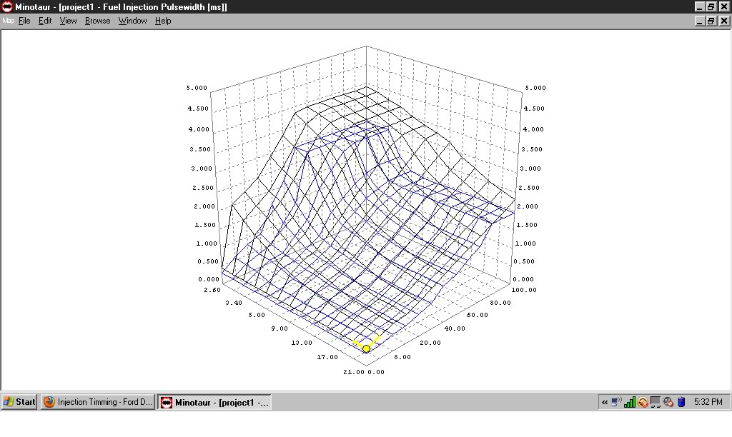

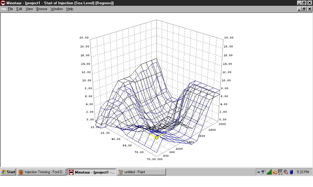

SOI and PW Map Overlays
I stole these from another forum that 907DAVE posted back in 2010. I hope he doesn't mind that I post them here. I messaged him, but got too impatient. :) I just don't think he spends much time on the forums these days.

Looks like there is possibly a stock calibration with a modified calibration overlay. The pw looks a lot lower then the split shot calibration I was looking at.
