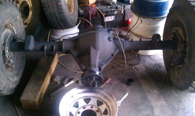

Well, put the 36s on and centered the axle since a friend was a no show and i couldnt move the axle to the shop to move the perches. New pics show trac width matches the front. The cummins is on its way. Would be here but had some effing debit card fraud over the weekend so im now broke for the time being so ill have to pay off the cummins weekly and then get the rsk. Dammit!

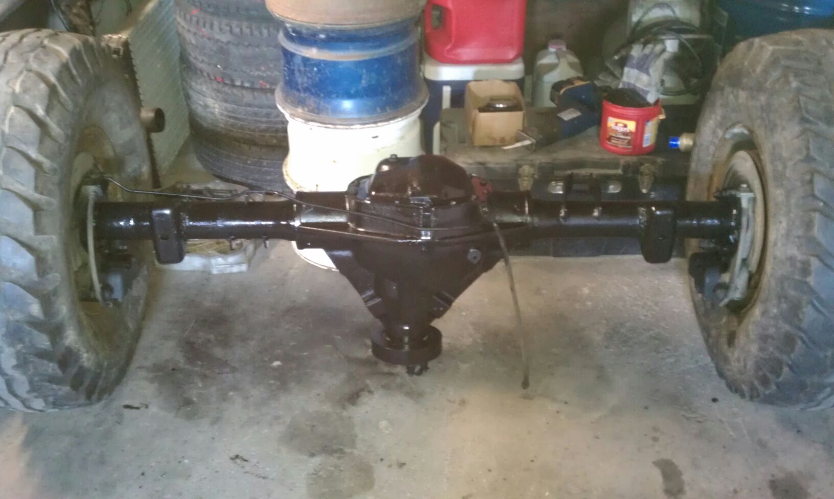

Well, got the perch and air bag plate off the driver side of my axle and moved the perch in and welded er back on. Doin the passenger side tomorrow! Talk about factory overkill on the welding on them bad boys! Most of its all coated in primer. Will finish priming and post a picture tomorrow after the other perch is done! Gettin excited to have it under the truck! Jus need to work on my stick welding skills haha

Rear axle is all ready for paint then mounting!

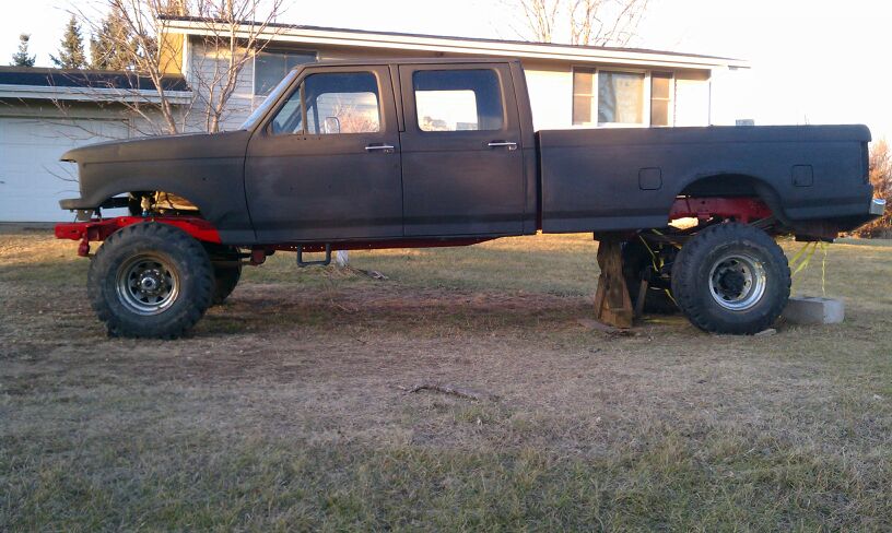

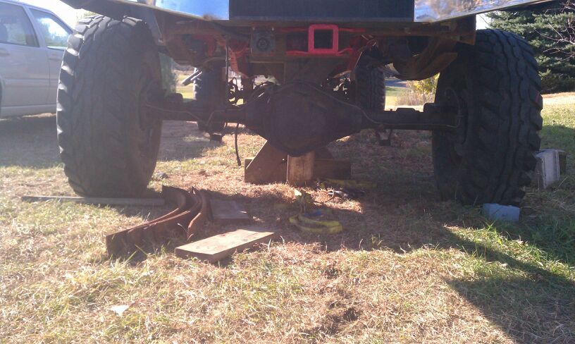

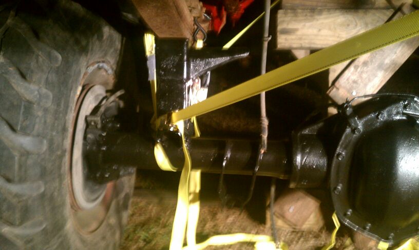

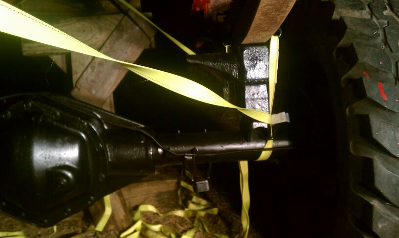

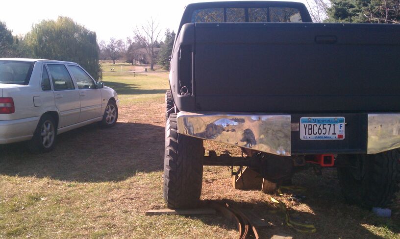

Well, the axle is all done and under the truck. Decided i want to take 1.5 inches out of the rear lift and going to order 6 inch blocks. The axle is currently ratchet strapped under the truck till u-bolts are made.

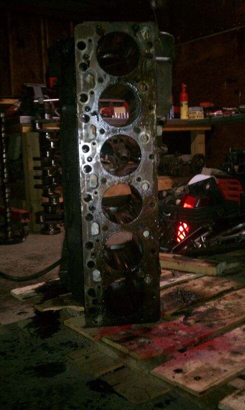

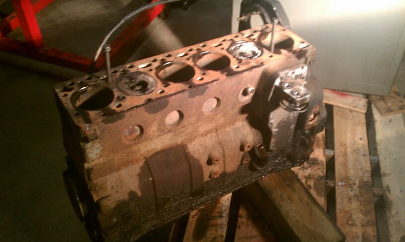

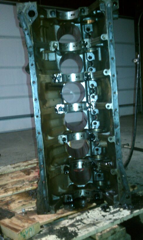

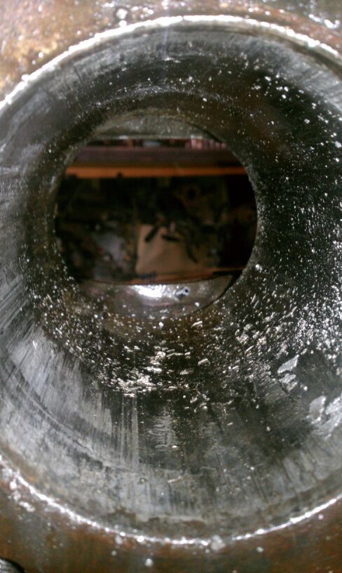

Cummins is here and torn down. Goes off to machine next weekend hopefully. Getting bored and having the head ported! The number 2 piston was seized in from melting and number 6 showed signs of starting to melt, but the block, crank, and rods are in pretty good shape yet! Getting excited to start building it.

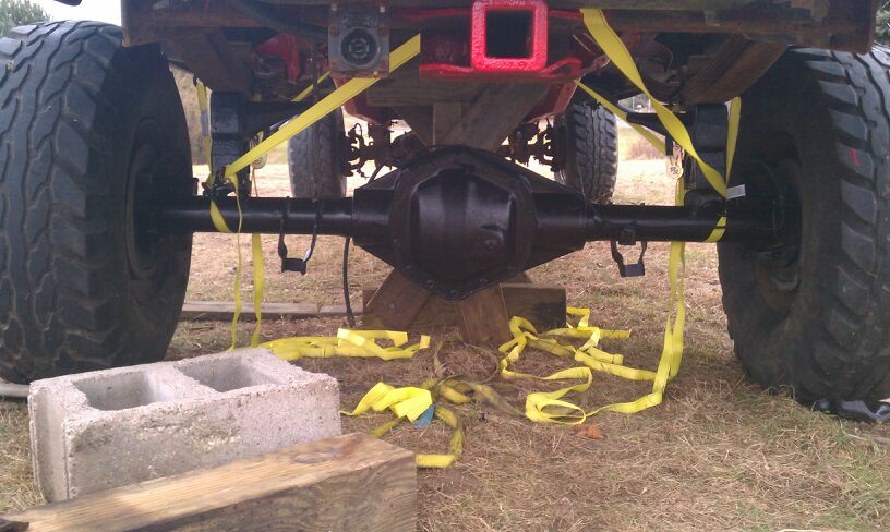

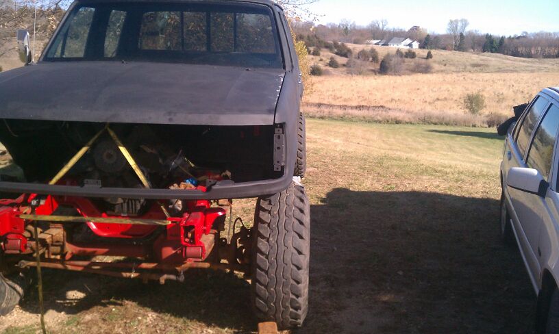

Some more with the axle underneath!

Don't get too concerned with the rear lift and having custom parts made for it until you have the weight of the motor and front end back together. 1.5" may be the ticket right now, but after the front is weighted down again, you may want to lower the rear stance more to get it a better overall look.
swamp_ratt
1,506
hudson, wi
I have a motor sitting in it right now, and when i pulled my 7.3 my springs didnt move. I have custom springs up front. So i know exactly where it will sit once i get it all mocked up. I am going to build my own 5 inch rsk. So once i have the front end all tacked and mocked up ill dial in my rear end
