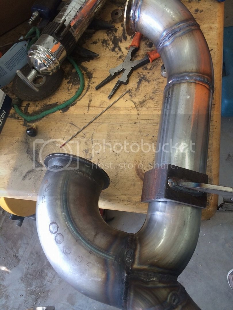

Was the air to water just not performing well enough or was it purely the fitment issues?
Under normal heavy acceleration the system would become head soaked and boil over pushing all the coolant out of the secondary cooling system. Expecially after doing all those doughnuts... So yeah that frozen boost was putting too much load on the secondary cooling system... Air to air is the only logical way to cool my intake air temps

I may be wrong... But it seems like the passenger side of the motor will be getting no air at all...
jcain
Jul 14, 2013
2,017
Both sides of the motor are plumbed in, albeit not the smoothest transition to the passenger side. Pressurized system don't care.
Isobaric
Nov 20, 2014
68
Navier-stokes would disagree with that statement....
Sent from my XT1060 using Tapatalk
Isobaric
Nov 20, 2014
68
Not saying it won't work for a temporary solution...just wouldn't run it like that indefinitely. Especially with the power you are pushing. Air temps aside I've seen some nasty chit happen when cylinders aren't breathing equally.
