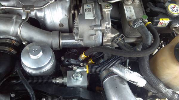

Thanks man, that would be great if you could get some pics, I havent seen one installed yet.
Wayne
2,540
8
Twin Falls, Idaho
hopefully this helps. when the airdog is installed, you pretty much need to max out the regulator on the airdog base, then nearly max out the aeromotive regulator. optimum desired Elite spec. PSI is 15 at the aeromotive regulator pressure test port. The airdog might not quite produce it. The truck this pic was taken on only put out 14, but that's fine. The two lines going to the frame rail need to be routed behind the L engine mount similarly routed to the factory solid lines that get removed. You may need to trim the heat shield under the LP turbo for the injection pump line to clear. Feel free to ask any more questions. I'll do my best to help.
madman1234509
Nov 20, 2011
2,669
mayfield, ny
So while we are on the subject. Let me make sure I have the flow/plumbing right on this. The large hose that goes into the distribution block and the feed from the airdog. The large line that comes out of the left of the block goes to the HPFP. The Line going from the fuel cooler to the regulator is obviously the fuel return. What is the line under the return from the fuel cooler on the regulator? Fuel return to the tank? I thought that normally comes out of the bottom of regulators? Is there no line coming out of the bottom of this one? Lol sorry for all the questions. Normally pictures and descriptions Ive found for the kit are pretty vague on plumbing and flow direction
Wayne
2,540
8
Twin Falls, Idaho
supply line from airdog: main line entering top of junction block w/ 90* fitting
return line to tank: line at base of aeromotive regulator w/ 90* fitting attached
Line from fuel cooler: enters side of regulator
double male ORB fitting: connects rear of junction block to side port of regulator
injection pump supply line: connects to pass. side of junction block.
NOT PICTURED: quick connect fittings attach fuel supply and return lines to factory supply & return lines near L engine mount between mount & block.

Thanks Wayne pics help alot!
