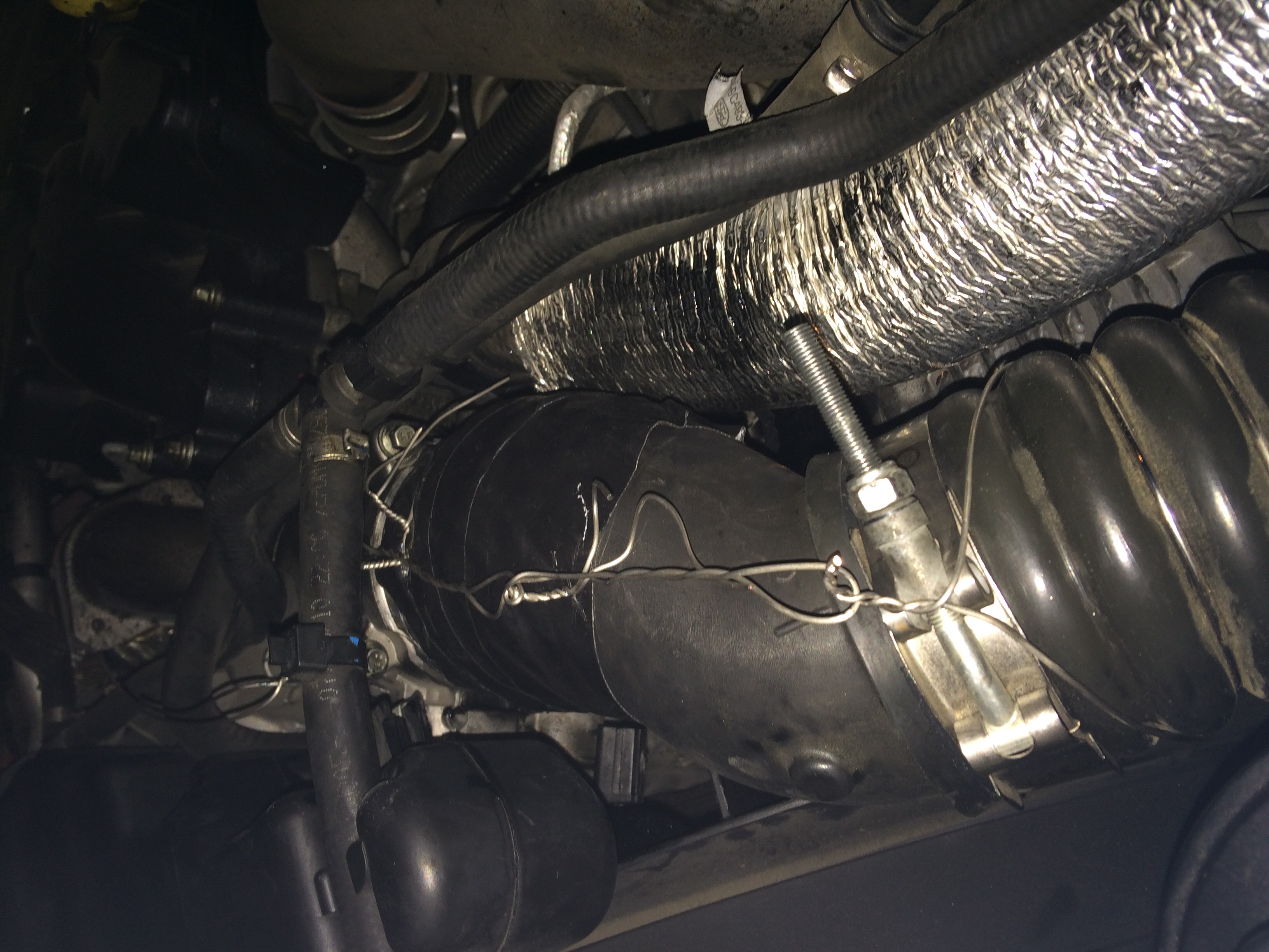

May not be the right place for this but if you haven't replaced the plastic crap pipe coming off the butterfly valve for intercooler you should. Pulling the boat from Port Mansfield, Tx back to San Antonio which is about a 5 hour run. Running about 75 and BOOM. Checked tires, all good. Hit gas peddle, lots of noise and lots of smoke. Pulled over and it had pretty much shattered the from part of the plastic piece that connects to the almuminum part that has the bitterly valve in it. We rigged up duct tape and wire and was able to make 5 psi to get me home.

I would tell everyone who has a 6.7 to buy one, not consider it. You would think ford would make something to replace that. What was worse is I pulled in a lot next to a ford dealership to half ass fix it.

Strangr8 - I have 120k and tow a decent amount, boat mostly weighing 7-9k maybe and I see close to 30 psi with it deleted pulling a hill.... And that's when it happen. It's a crappy feeling being 3 hrs from home on a Sunday with no one open for parts. After this happening to me, I would bite te bullet and do it. It will save u later.

Have a replacement piece with you or go buy the H&S and get it over with. The boost pressure literally shattered/exploded the whole top of the plastic where it connects to the butterfly valve.
