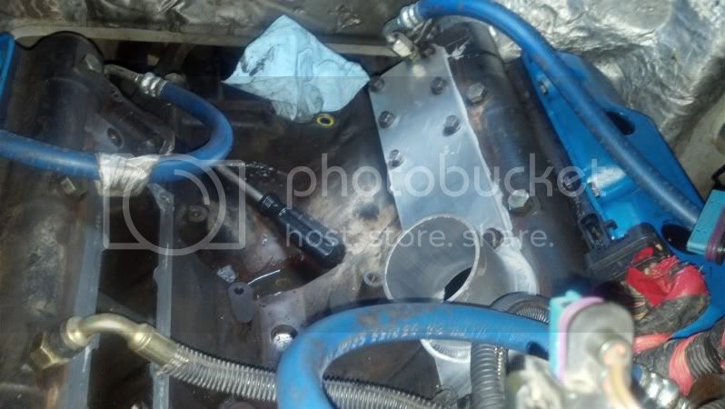

The 467's have a very large race cover on them. I am trying to have him measure the flange to make sure I didn't send out an old height flange. Which would be the cause of the compressor cover hitting the bolt head.
Marty, thanks for posting up some picture of how you've ran your intake plumbing.
And the plenums were rocket science, took the factory one to the machine shop and told them to cut me some flanges with a hole in it to weld a 3" tube to it! Have 8 more sets on the shelf if anybody needs them! They are $225 a set shipped.

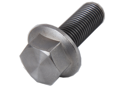

I've seen a lot of funny things you'd never expect to happen, happen under pressure. You may not even have a problem BUT I for one would never leave that open. I would get a flange head bolt and remove what I had to for clearance and install it. Obviously you can do as you please :D
Excuse my ignorance...but what is a flange bolt?
Sent from my DROID BIONIC using Tapatalk
Which is what you are using now. There is also an m8x1.25 that instead of having a 13mm head like yours, has a 10mm head.
My idea was to use:

So Marty the threads are the 8x1.25?

Yes, they are a 8x1.25 thread. Pry want it to be 30mm long 35 at the longest.

Jake, they're a good bit shorter then 35. I'm thinking 15mm. I will report back tomorrow.

I think 25's or 30's would work. The flange is about 6.3mm thick. I didn't throw the calipers on a stock one today.

Looks like the average depth is about 20mm, to be safe. The flange of the plenum is ~6mm.
