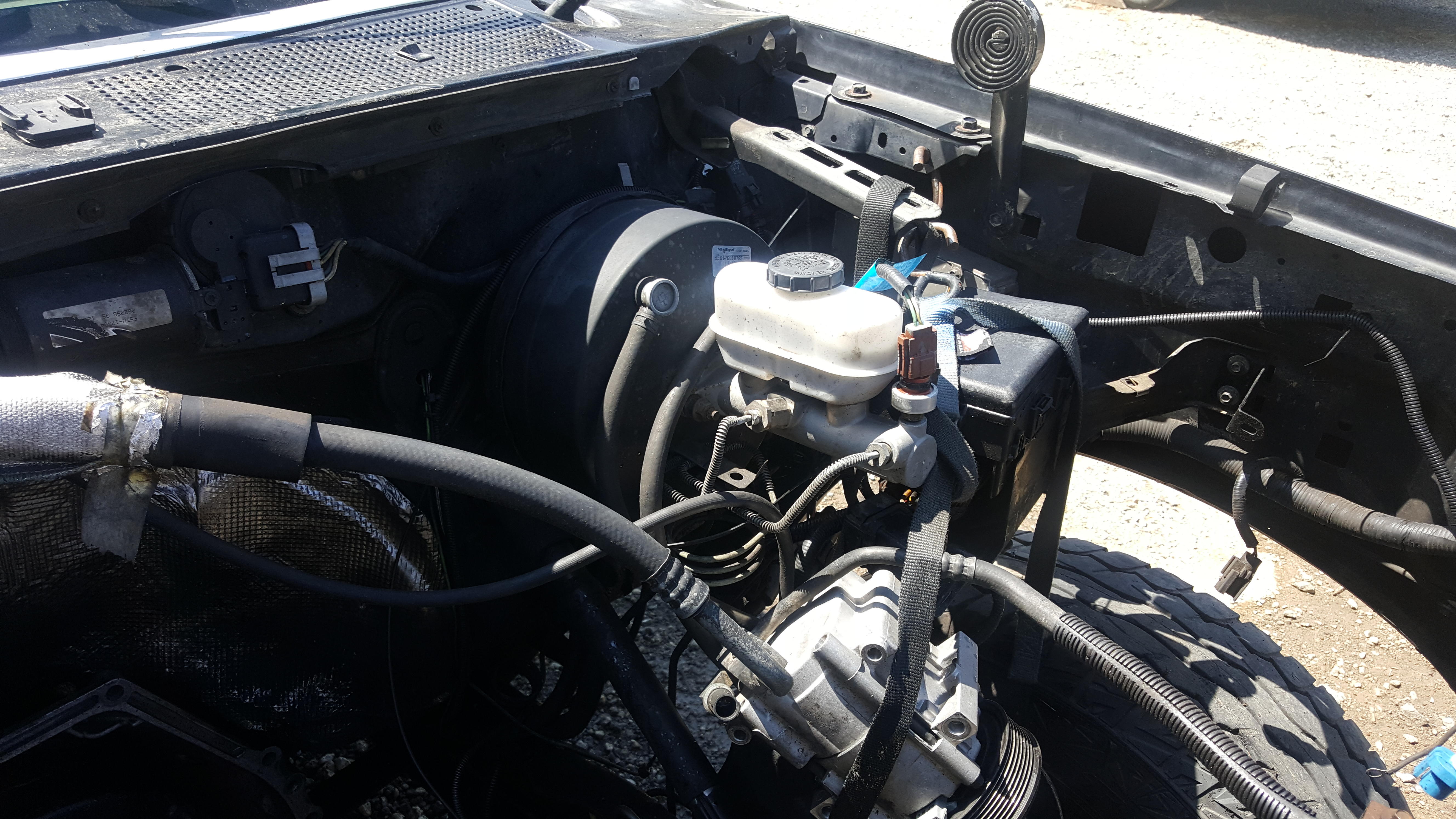

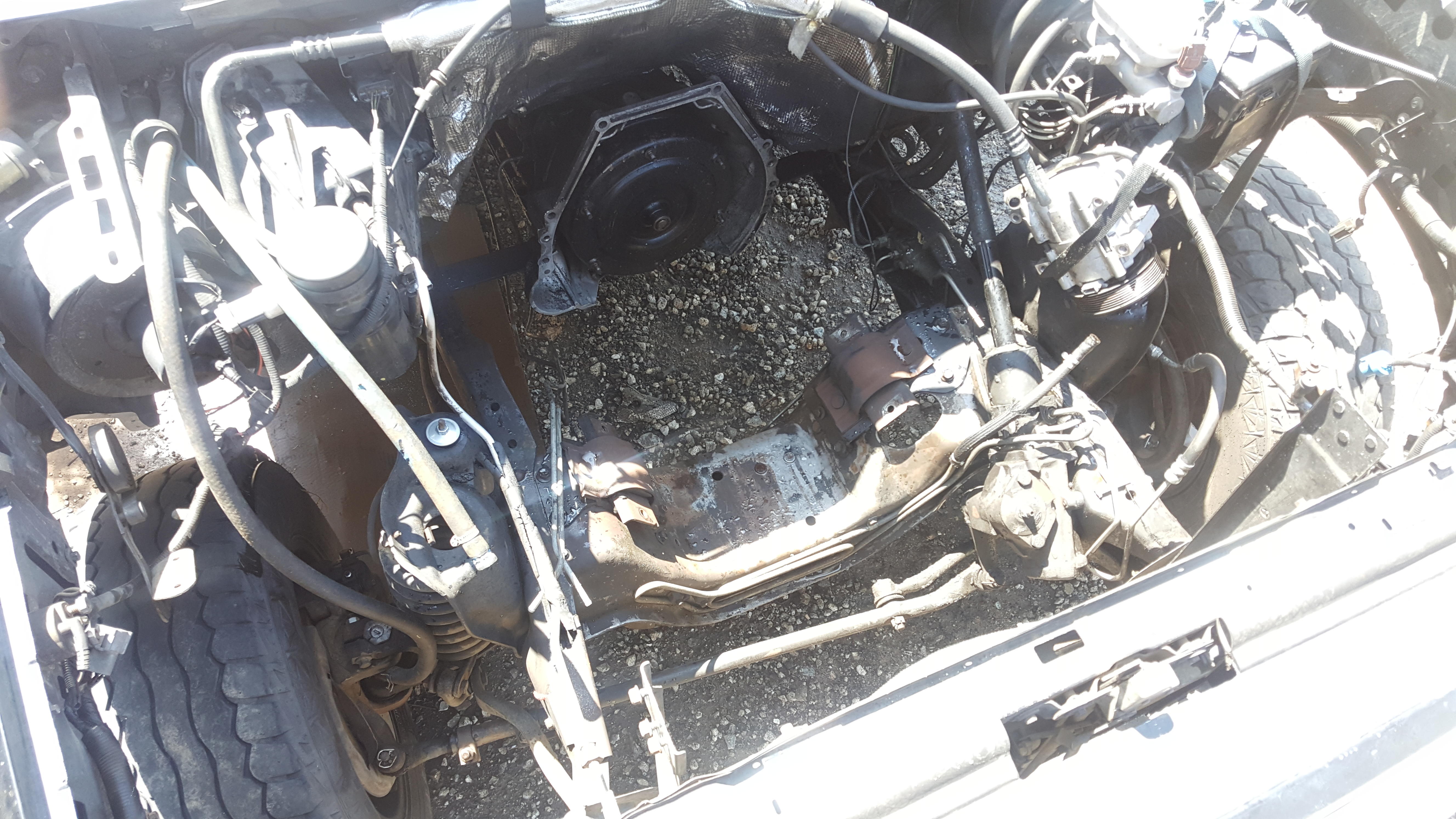

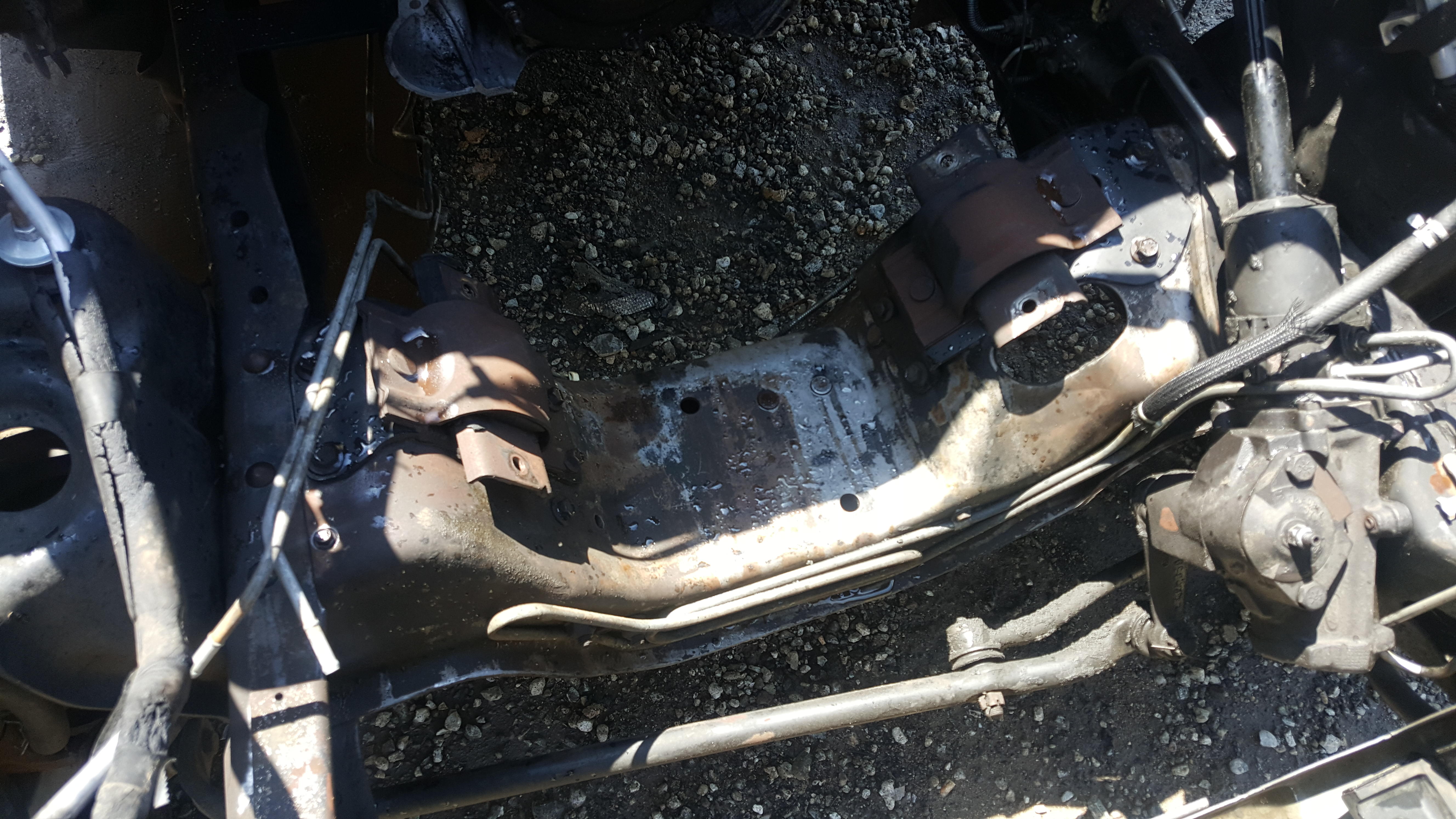

Cleaned up the engine bay today with a good pressure washer, took off 20 years worth of grime, and even some of the factory undercoating! But shes mostly clean and ready for me to shoehorn this big ass 7.3 into it!
Im going to attempt to install it fully assembled, minus the fan. So i want to install it with the exh. manifolds, up-pipes, turbo, and maybe the front accessories. That way i can do all the torqueing and hard to reach bolts out of the truck, then just lower it in.
Ill let you guys know how it goes, i think the turbo is going to be the deciding factor if it goes in or not, but maybe without the radiator and without the fan, it just might fit.

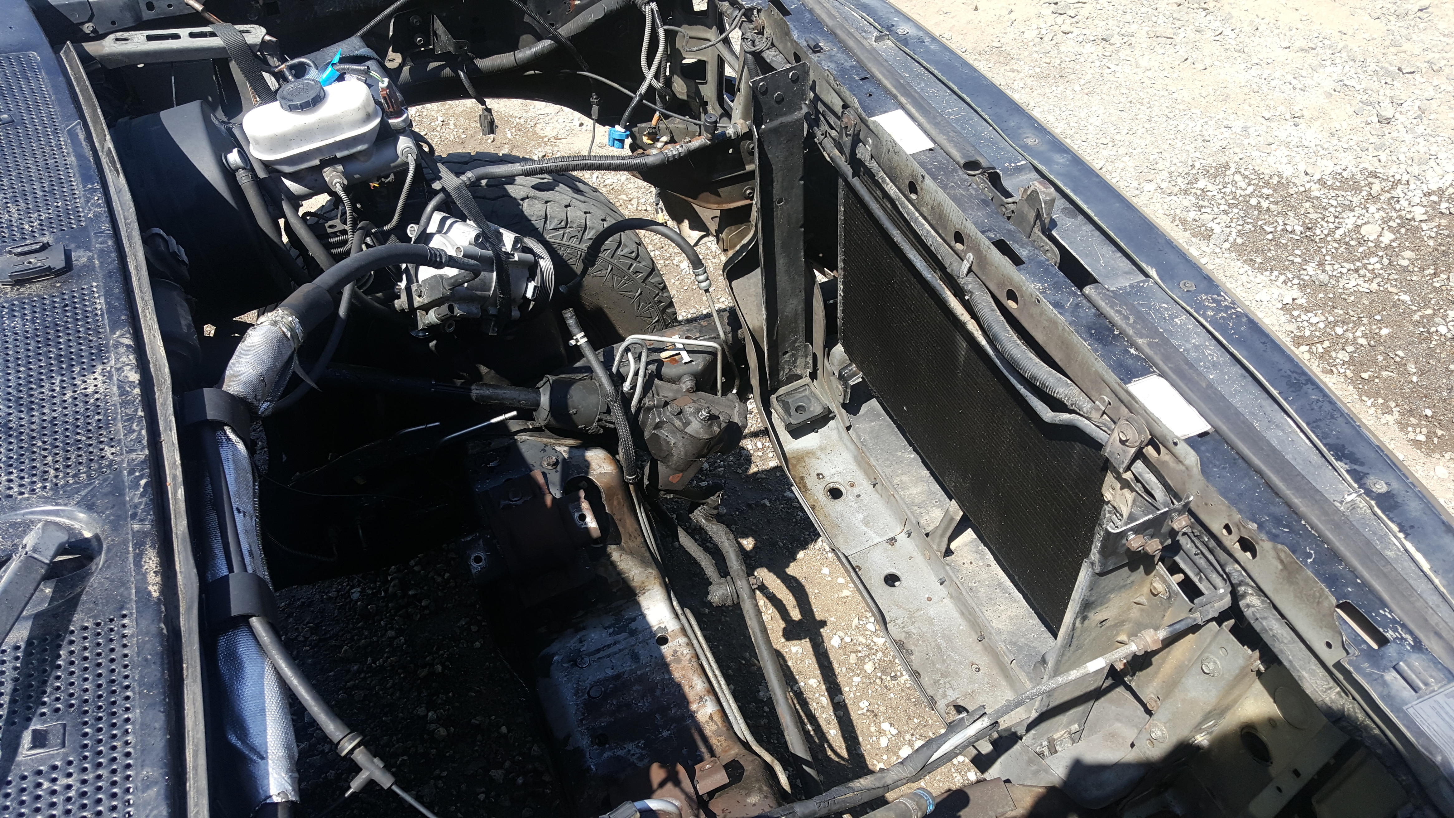

I was thinking about it, but after looking at it, it looks like a lot of work to get the core support out... Plus im still trying to keep the A/C System in tact, and removing all of that stuff, i would have to remove the condenser... If worse comes to worse, i might unbolt most of it, and lean it all forward, but we will see how it comes out.

If my memory serves me correctly you might be able to unbolt the condenser, wrap it in a blanket and flip it back to the side out of the way.
