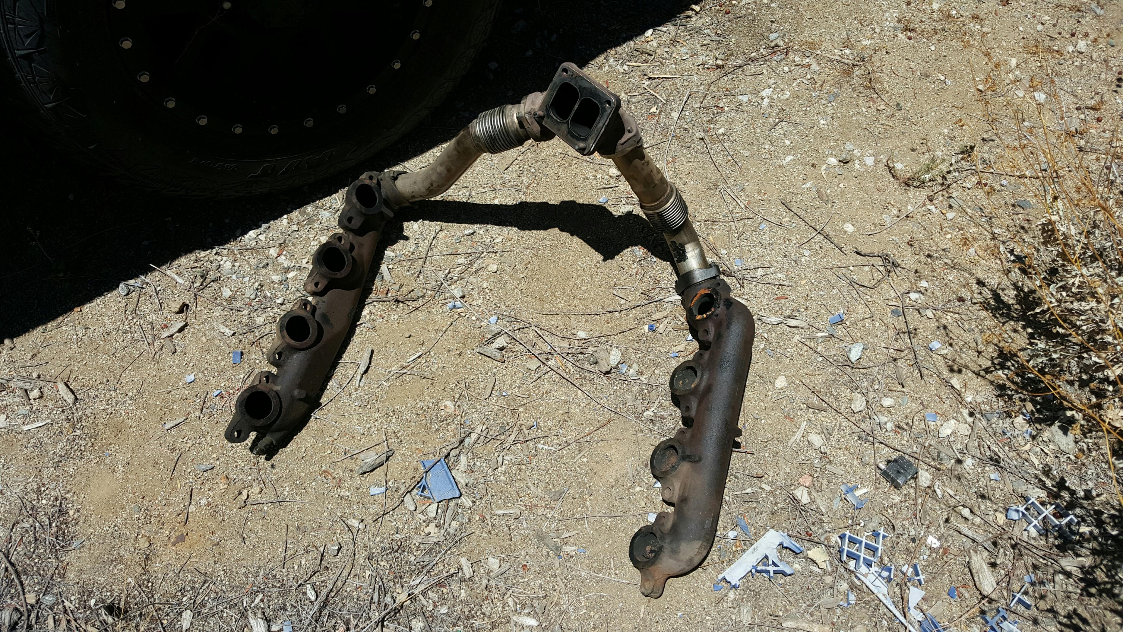

Still havent heard from the machine shop, going to call them on Monday. Did some work on the truck today, didnt want to do that much, as it was 107* here in socal at 11am. So i just pulled the power steering pump, the manifolds, up pipes, and collector as one piece, and the downpipe. Now i just need to pull the starter, disconnect the fuel lines (which i bought the disconnect tool from Matco last week, nice billet aluminum piece), and unbolt it from the truck, and it should come right out.
A question i have now is, since i removed the ebpv valve from the truck, would i be able to plug up the ebpv tube that runs from the passenger side exh. manifold to the sensor? Basically i can get a threaded plug or even weld up the manifold and get rid of the entire tube/sensor and all. Or would this cause other problems that im unaware of?

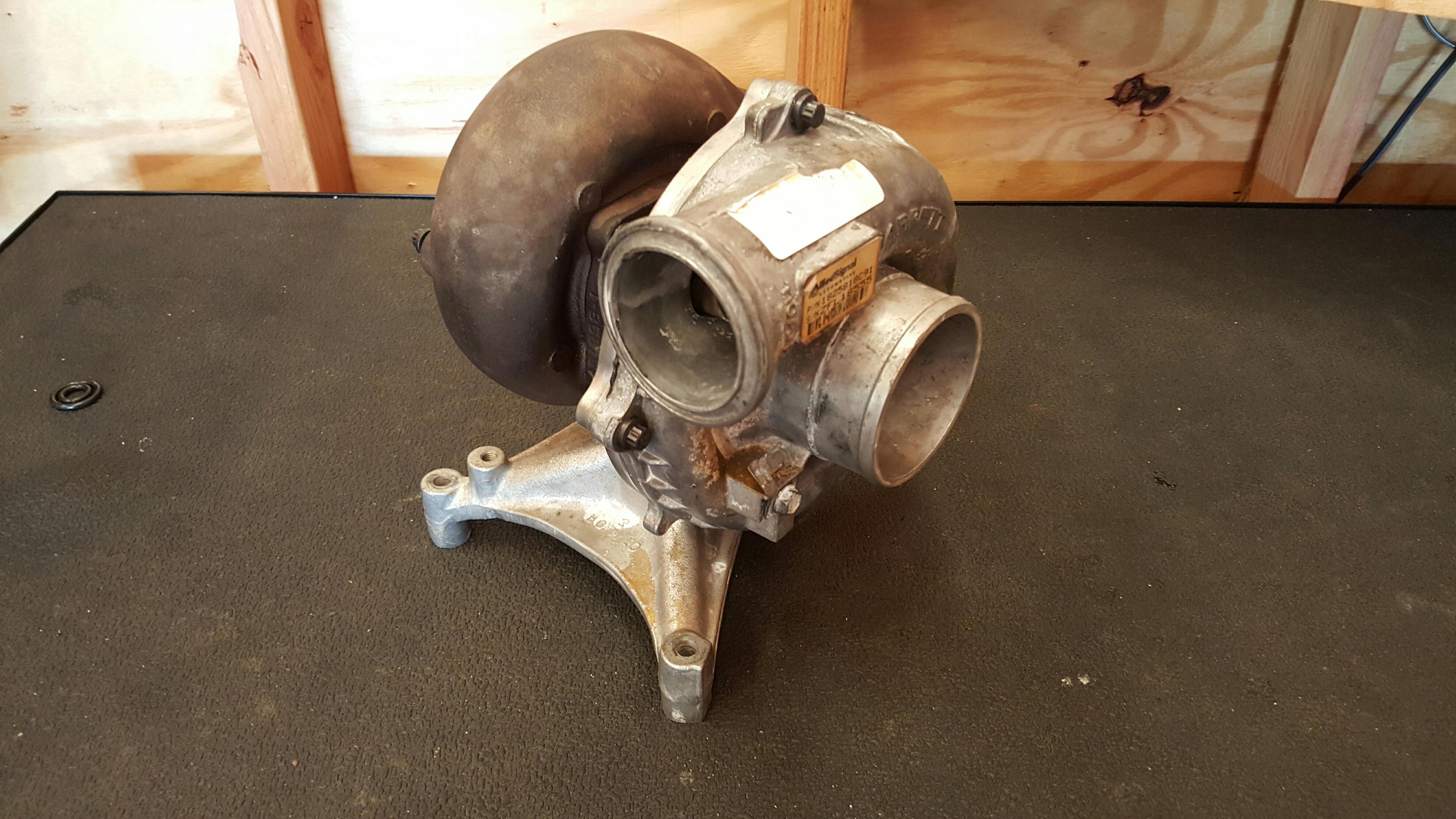

I also got pics of the turbo fully assembled. I didnt make it quite as pretty as i could have, but i sent it through our steam cleaner/parts washer thing, so theres no oil/grease/grime on it atleast. Itll do for now.

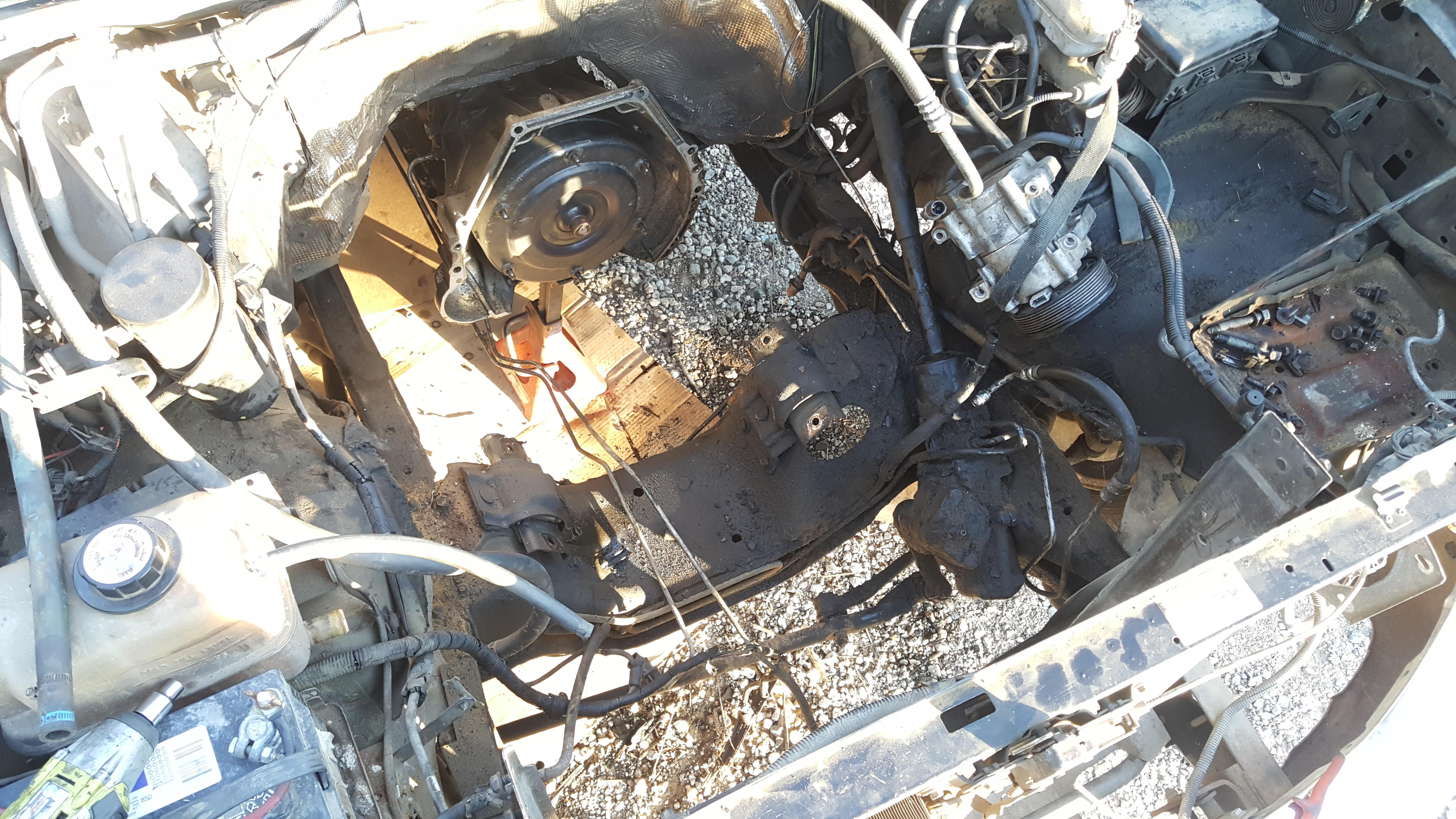

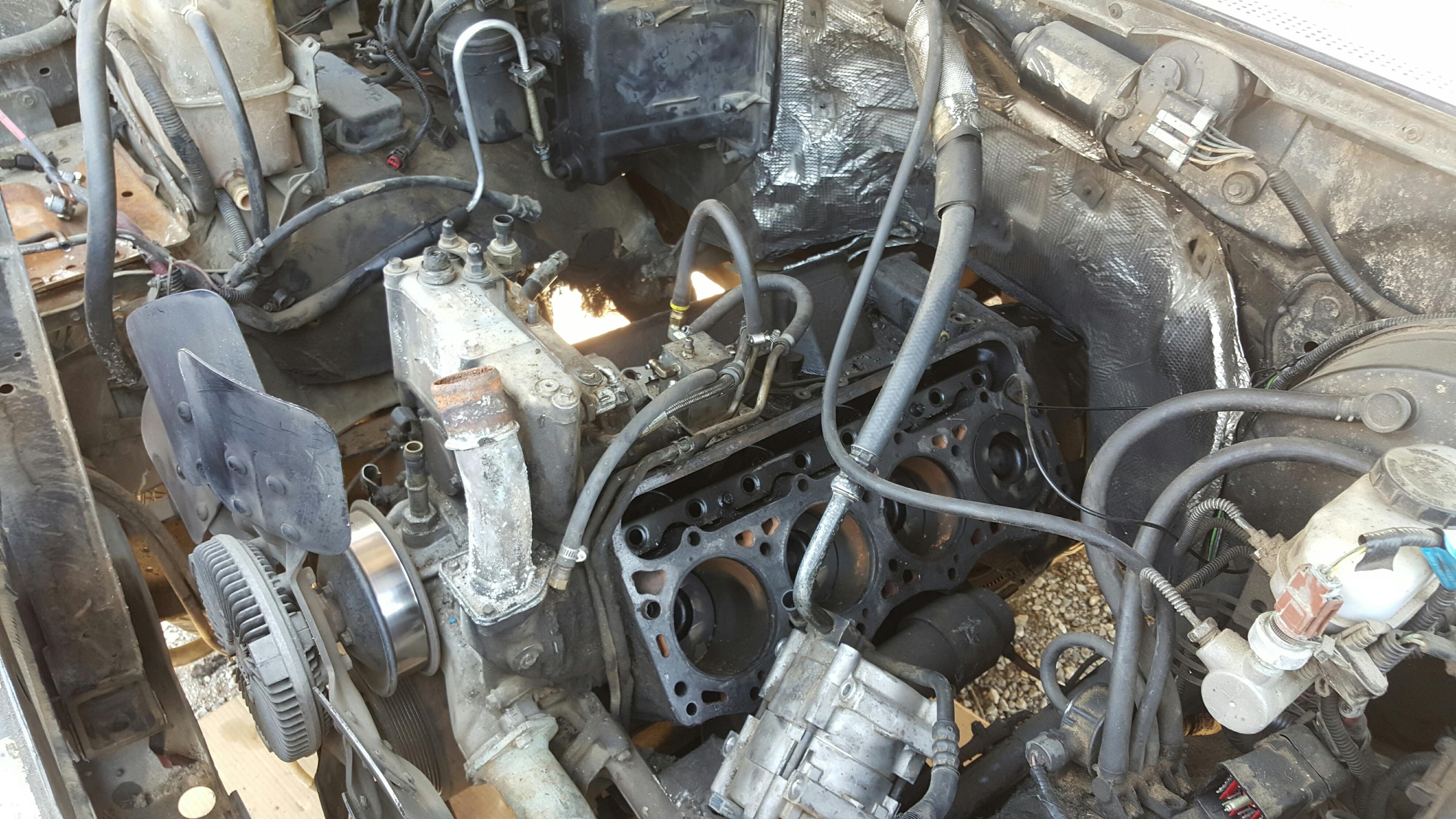

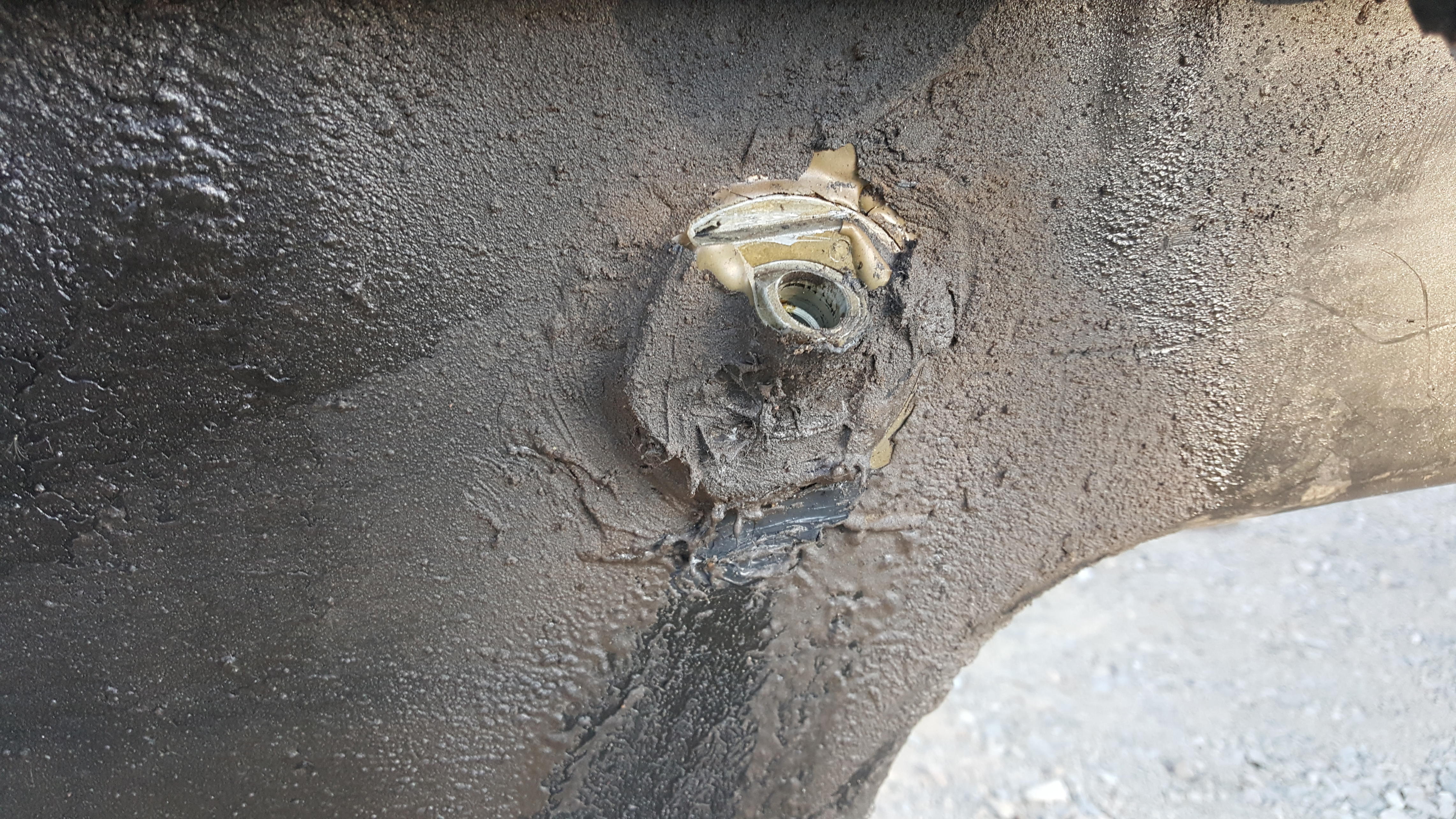

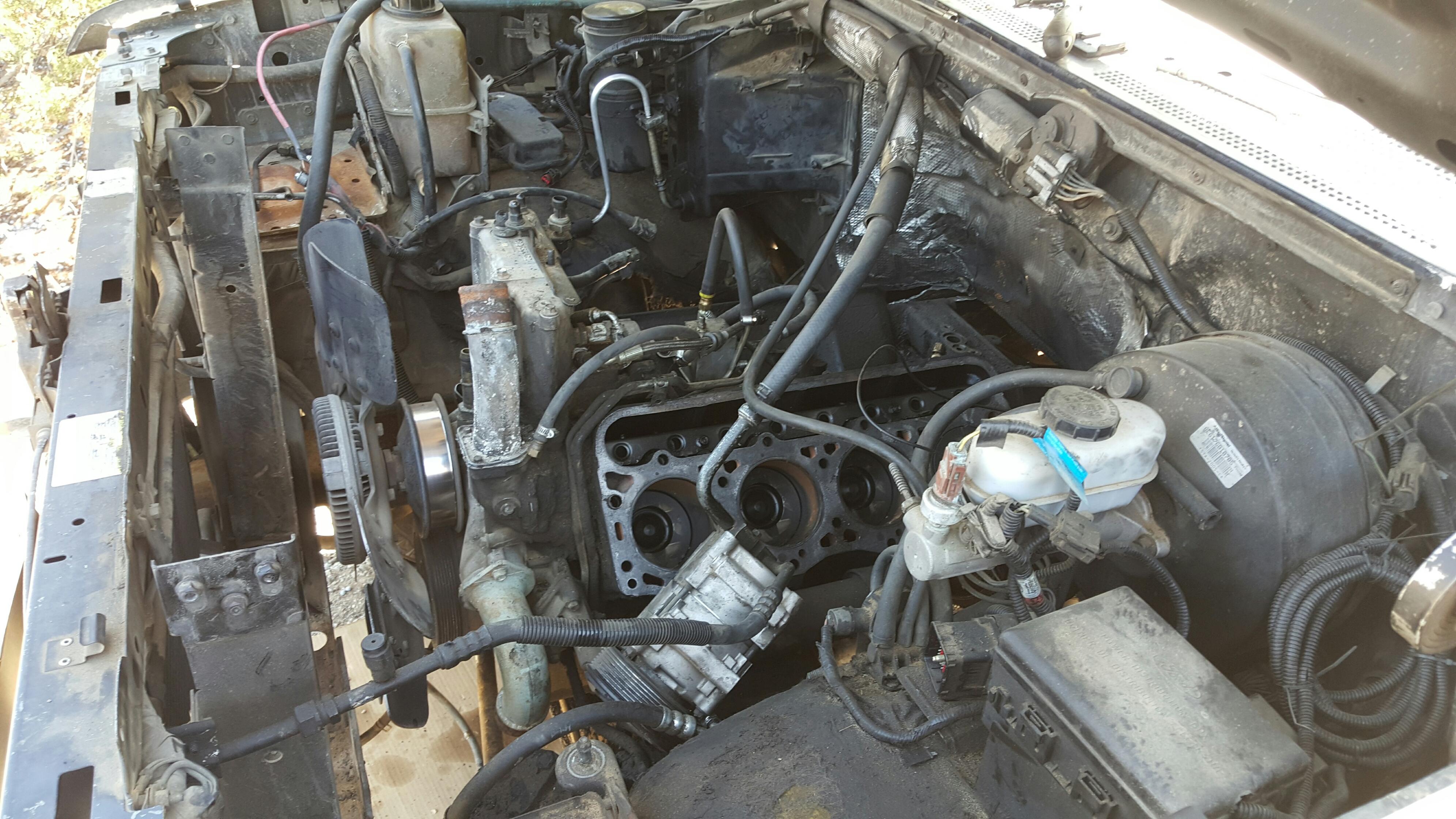

Got the motor out, came out a lot easier than i expected, didnt have to rotate the motor 90*, but i did have to tilt the front up a little bit to clear. Left the radiator fan on, and the entire AC system is still intact, just strapped up out of the way. Now the cleaning begins!
My buddy also picked up the motor today and is taking it to his shop. Going to clean it, amd do a leakdown test, if it comes out good, then hes going to pull the pan and check out the bearings, and if that comes out good, then hes going to reseal the oil pan, do the front cover, and rear main seal, and do the dipstick repair kit i bought from riffraff.
He also heard from the machine shop today, they said the heads are in perfect shape, no cracks whatsoever, and the surface was only .003", and they were debating on if they should even deck the surface! They decided since i was this far into it, i might as well, and its not very expensive. So they are machining tomorrow!
We also realized something once we pulled the motor out... The oil filter was still attached to the motor. Meaning it was still full of oil, and wasnt "contaminated" when i pulled the heads off and spilled coolant everywhere. So we are going to siphon what we can out of the filter and have an oil analysis done. Hopefully it can tell us if there is coolant in the oil, or fuel in the oil, or neither?
I also gave him all 8 injectors, hes going to get them tested, $40 an injector, and see how theyre holding up. It will tell me how old they are as well...
When i get the motor back, it should be pretty much assembled and ready to drop in, other than put the valve covers and turbo on, and fill it with oil. Oh and install it in the truck...
Im getting overly-excited about getting my truck back!
