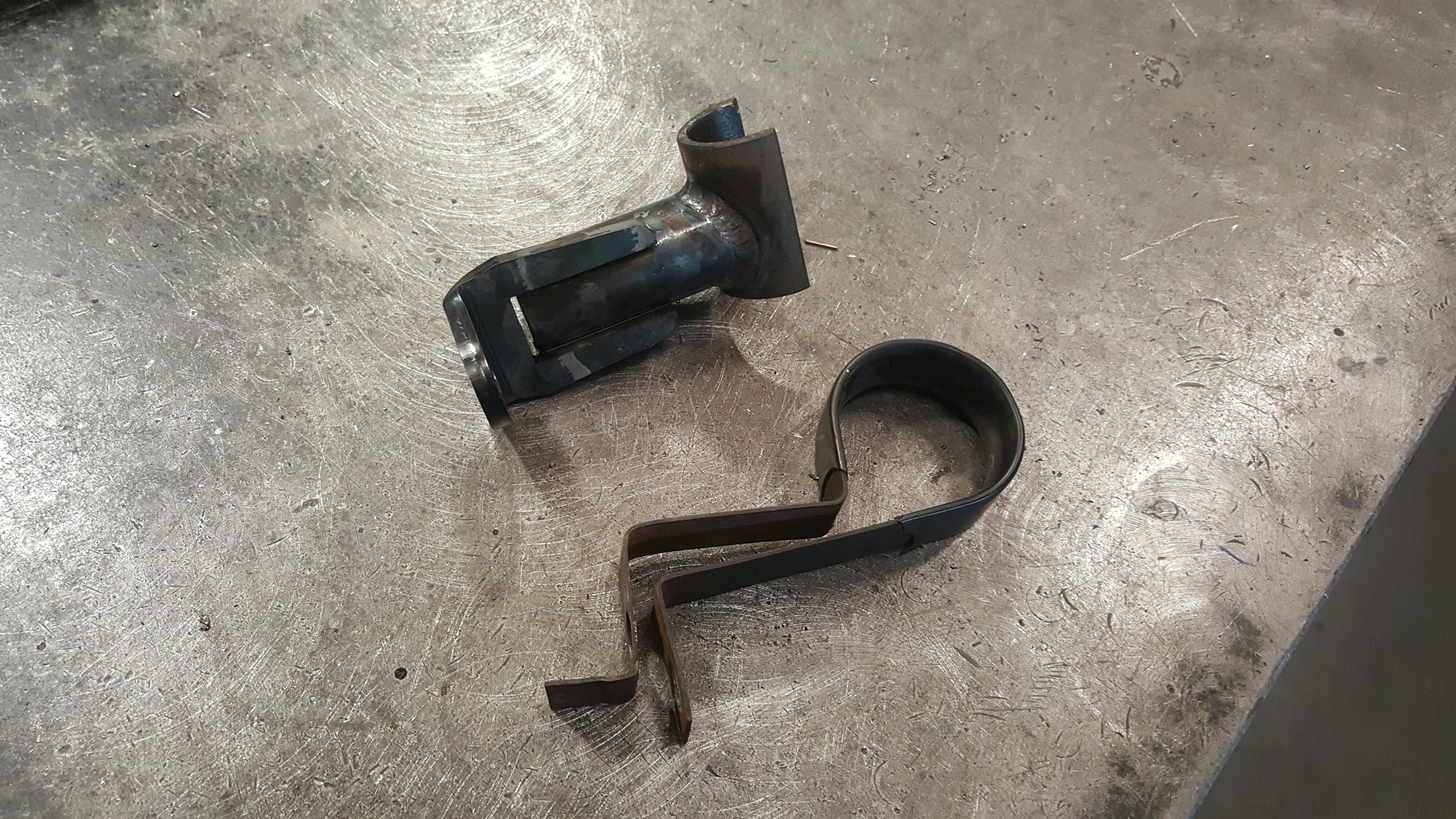

I saw on another thread that Rosewood Diesel makes a heater hose holder for the OBS trucks because the stock bracket bends all the time. So after going out and checking mine, sure enough, it was bent and had fallen over. So i straightened it out and i was going to add a gusset to it so it wont happen again. But then i just decided to make one out of some material we had laying around the shop. So now i have a super stout Heater hose bolder that i made myself. Made it up with some scrap tubing and a tab that we use often here in the shop. TIG welded it all up and its ready! I think ill get it powdercoated too.... (it looks funny in the pictures because its wet, i had just dunked it in water to cool it off.)
