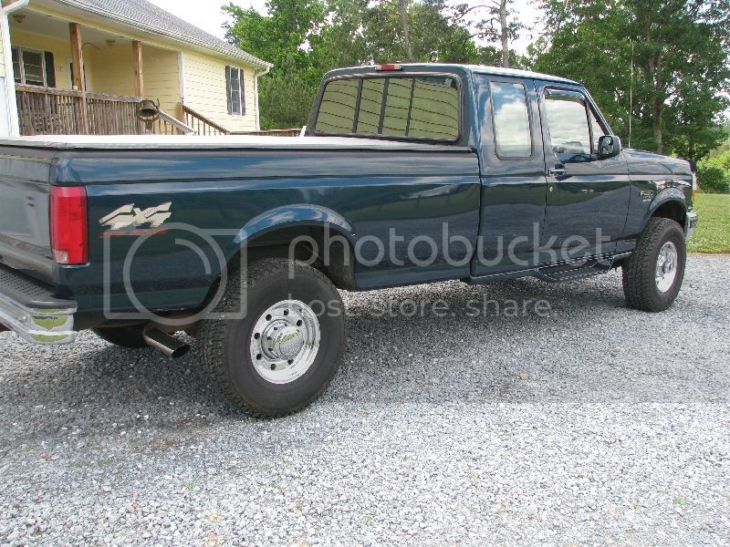

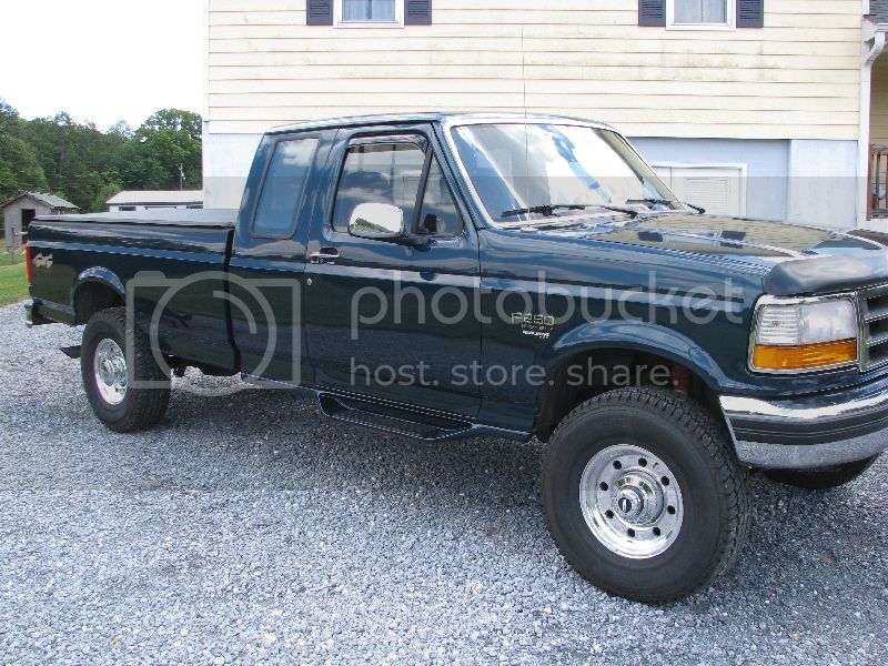

Tom, my truck has always had 285 tires on the stock Alcoa (crept for a few months when I tried out the Eagle Alloys). Dad nor I have ever had an issue with the tires wearing incorrectly.
If you don't want a 285 on your Alcoas look at the 255 85 16 tire. Tall as a 33 but a bit narrow to fit just right on a 7" rim
