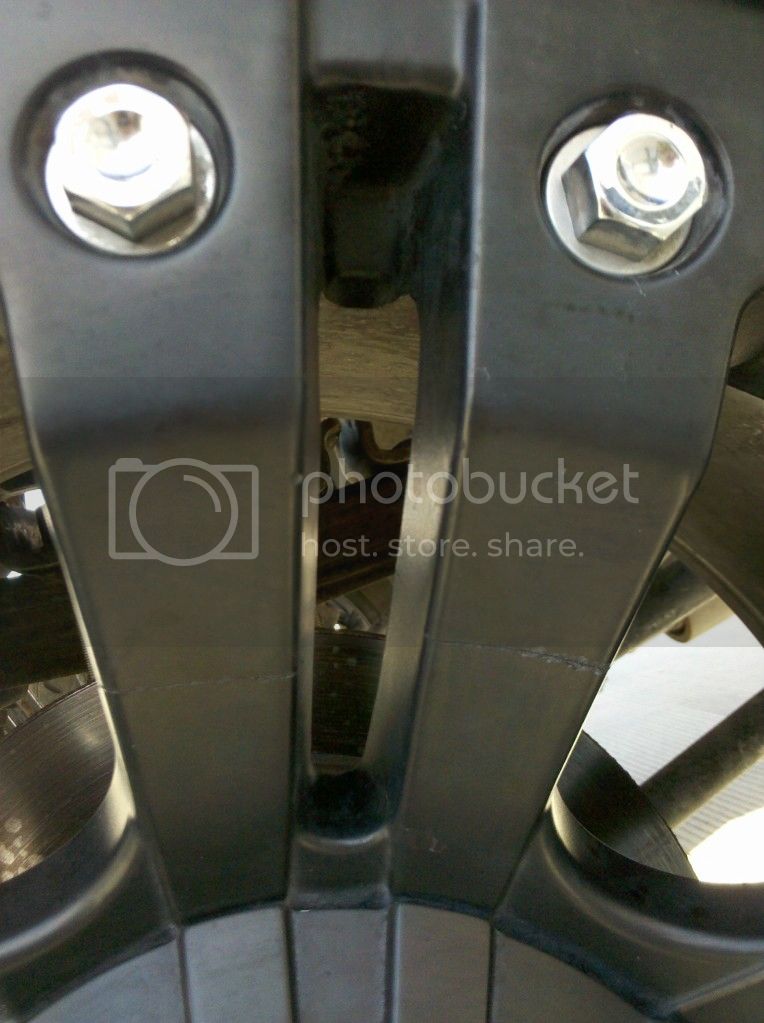

Was doing my winter inspection this weekend...Good thing I notice this..This could of been a disaster waiting to happen...About 4 years ago I bought a used set of 16 inch Moto Metal aluminum rims.They where perfect at the time..But found one front rim with 8 cracks running towards the centre of the hub,right where the lug nut go..
I always used a torque wrench on the lugs and torque them to 120 foot lbs..I'm going to remove the rears and check them also..Now I don't trust these rims...Maybe should replace them all.. Or buy a replacement rim? I haven't priced out a rim in Calgary,but by other Alberta posts,maybe I should order a rim from the US...Seems Mr Wheel Deal is the one to use..
What to do... Anyone see cracks like this in aluminum rims??

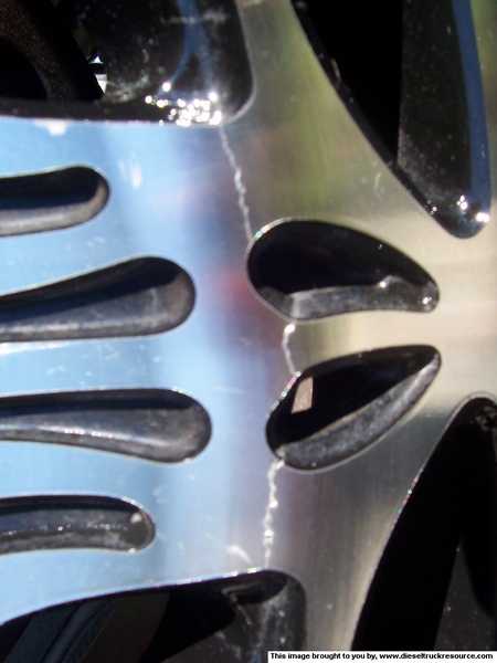

I also went through 2 complete sets of my moto metal skull rims. Both sets were covered by warranty. All 8 of my rims cracked way out by the "eyes" and through the nose of the rims. Now on a set of fuel rims......
I discovered back on 7/1/11 that one of the Moto Metal Skull wheels on my new 2011 Dodge Ram was cracked in multiple places (same as you described). 4 out of the 5 skulls had multiple cracks, so bad that the center section was about ready to break out. I haven't even had a chance to get my truck off-road.
I contacted the dealer (in Idaho. I live in N.Ca) and they shipped a new wheel to me without hesitation.
I shipped the wheel back to the dealer and they called me to say how shocked they were and mentioned how lucky I was to not have a complete wheel failure and resulting wreck.
I stayed with these wheels as I figured this might have been an isolated incident. Was I WRONG!
As you can probably understand, I made a walk around my truck everytime before driving it and checked every wheel.
On 9/7/11 while checking my wheels before departing for work, I discovered I had 2 more wheels with cracks in them. Again, 4 out of 5 skulls were cracked! That's 3 out of the 4 original wheels with major failure.
Contacted the dealer again and their first words after hearing this were "let's get those wheels off there now". I picked out a new set (XD797 Spy's this time) and they shipped them to me right away, again free of charge and rightly so. They even paid for the mounting/balancing at my local shop.
I do have to say that Wayne at Dave Smith Motors in Kellogg, Idaho really stepped up and handled the situation. Thanks Wayne!
There was no way I will ever driving anywhere on MM Skull wheels or take the chance on any wheel from Moto Metal. Tried contacting the manufacturer and they were absolutly 100% useless in helping to resolve the situation.
Last I checked there has not been an official recall of these wheels but I can only hope that the manufacturer steps up and gets these things off the market before someone is seriously injured or killed.
My opinion/advice....if you have these, get them off now! If you're thinking about getting them, DON'T!
