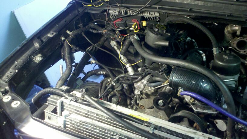

This is what I got done today

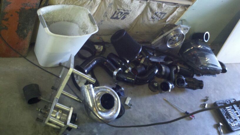

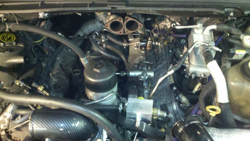

And this
The reason for tge 71 is ellerton od using one with good luck. A local truck runs the 66 and spools great still so I figured a 71 would be ok. Might have a litter lag I can deal with some if I'm making power in trade but I think it will spool decent

O man... project is goin fast! There is a ton of room in that wheel well. So Im not clear on your downpipe route... Are you going outside of the frame in the wheel well or staying inside?
