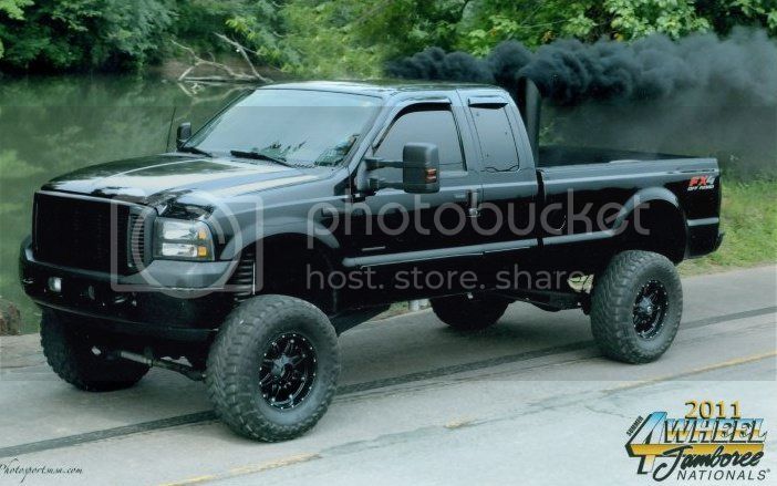

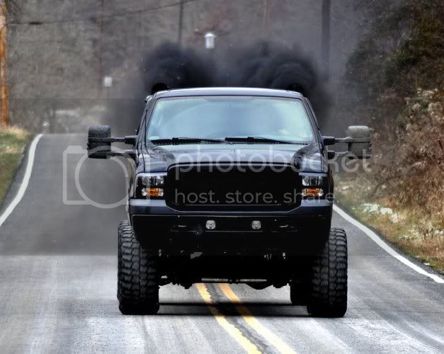

My 06 F250 when i first bought it: 6" Pro Comp lift, 18x9 XD Hoss wheels -18mm offset, 36x15.50 Dick Cepek Mud Country tires

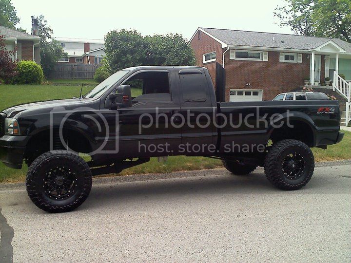

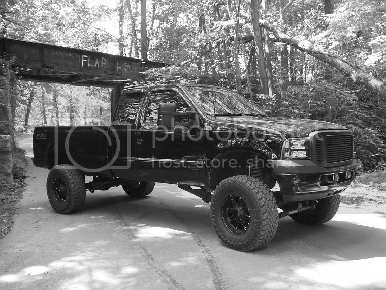

with new wheels and tires: 18x9 Fuel Hostage wheels -18mm offset, 37x13.50 Toyo Open Country M/T tires

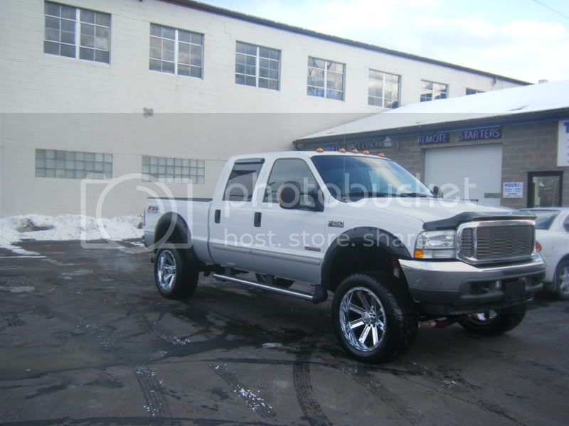

Old truck 04 Lariat F250: 4" Rancho lift, 22x11 Driv Blitz wheels -56mm offset 3.80" backspace, 325/50/22 (35x13.50) Kumho Road Venture AT tires...these tires rubbed the inner fender quite a bit
with 18x9 American Racing Cannon wheels -12mm offset, 325/65/18 (35x12.50) Nitto Terra Grapplers

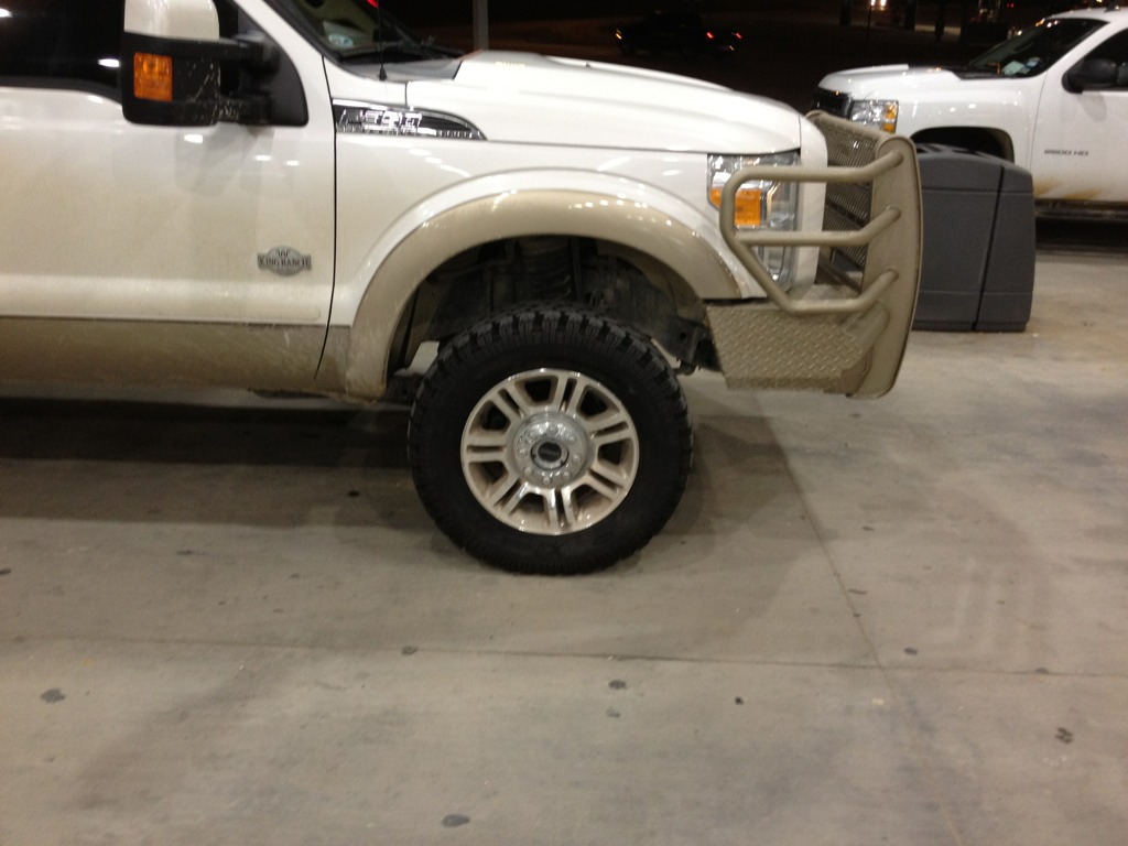

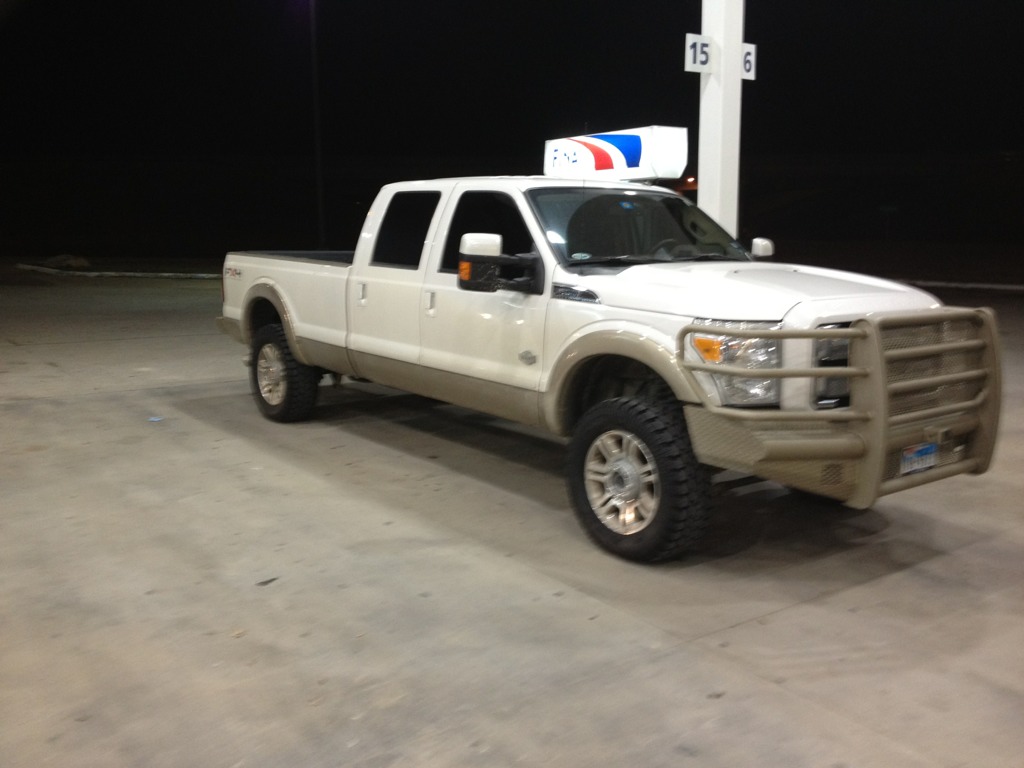

TXGLASSMAN
3,407
Keller Texas
2.5" icon leveling coil springs
35/12.50/20 pro comp xtreme ATs on stock king ranch 20s no rubbing at all
