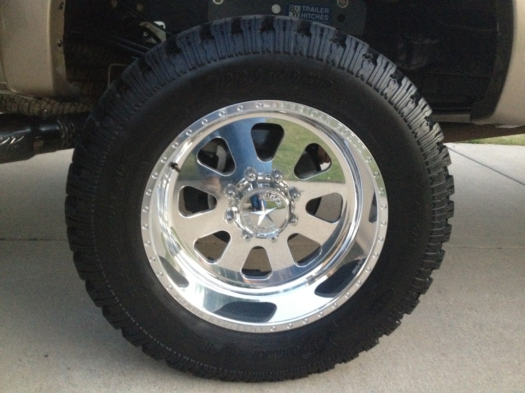

20X10 American Force Recon Wheels, 35/12.50/20 pro comp extreme ATs
4.5" icon coilover suspension

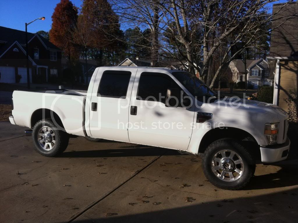

I noticed that there are a lot of threads started on the forum related to wheel size, tire size, and what will fit at certain ride heights without rubbing. I am starting this thread so everyone can post up good technical information about what has worked for them and what hasn't worked. Pictures of setups are definitely good. When you post up pics and your setup, be sure to include wheel specs, suspension specs, and tire specs. That way it can stay more technical and helpful rather than people just showing off their setup.
I'll start...
Factory 20x8 wheels, 295/60/20 Nitto Terra Grapplers, stock height F-250. The tires measure roughly 34" tall and 12" wide on these wheels. There is no rubbing anywhere with this setup.
I have this setup on my truck, the only difference is my wheels are 08 Harley wheels. It rubbed on my stock radius arms but not enough to notice until you crawled under the truck and actually saw it. I put OUO Adjustable Link Arms on it and it rubs pretty good at full lock now.
