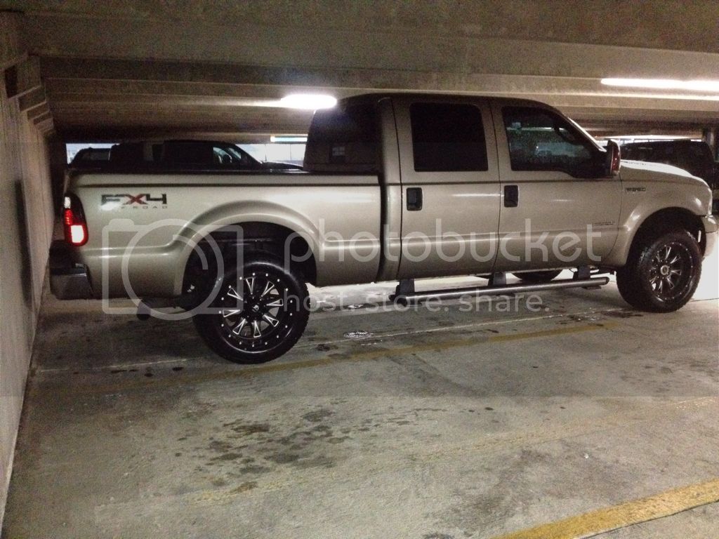

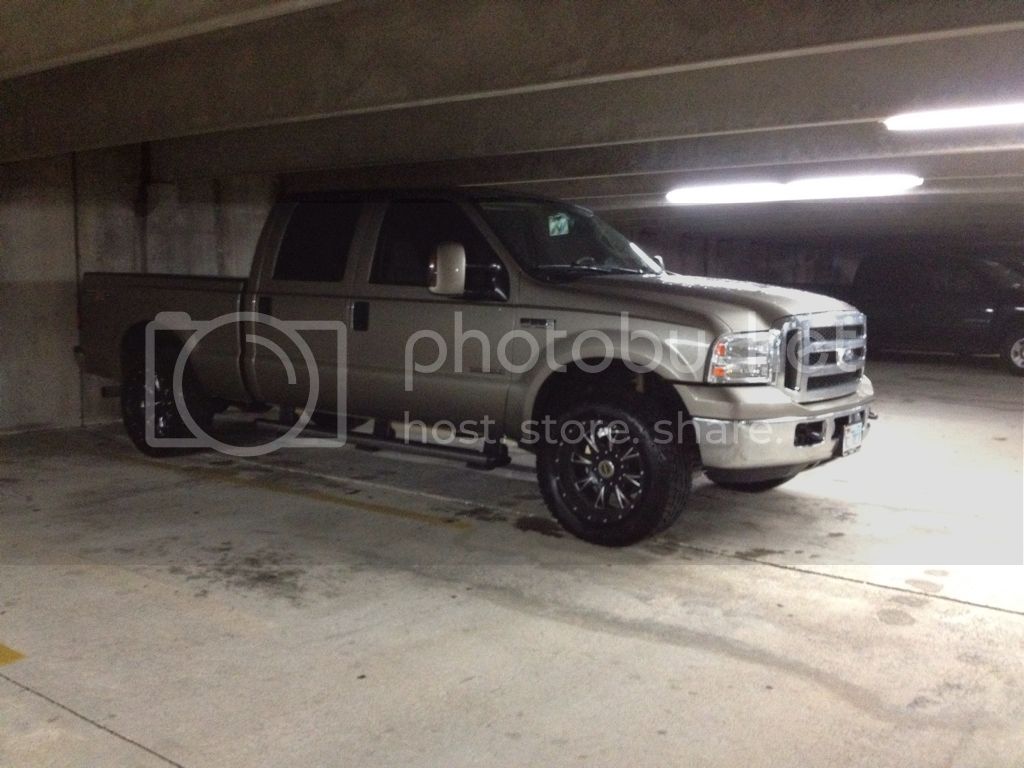

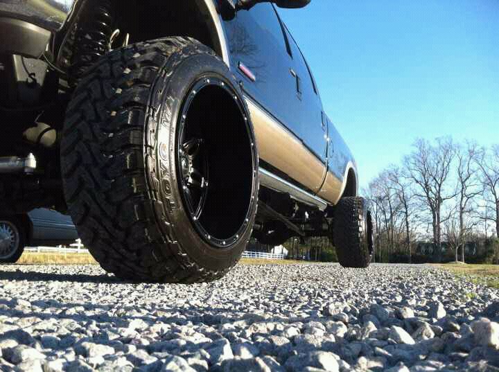

Thanks man heres another with the 36x15.50 Dick cepeks...better view of how they stuck out

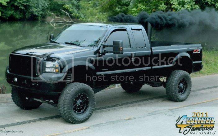

and an action shot with the 37x13.50 Toyos
Off topic but did you ever race at the flashlight drags in Ebensburg? I ran a truck just like yours one time there and wondered if it was you...

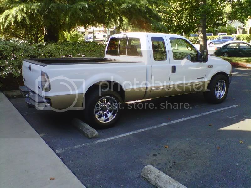

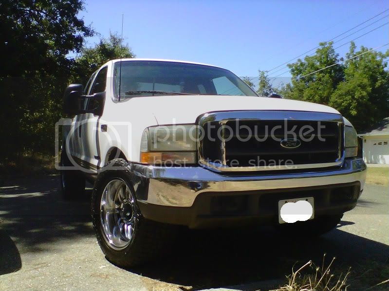

2000 F250 2wd stock height, 20x10 wheels with 4.5" backspace (forgot the offset) and 305/55/20 tires. No rubbing with the 05 conversion after pulling back the inner fender liner a little with a zip tie. I did have to hit the front bottom corner of the 2000 bumper with a hammer a little bit.

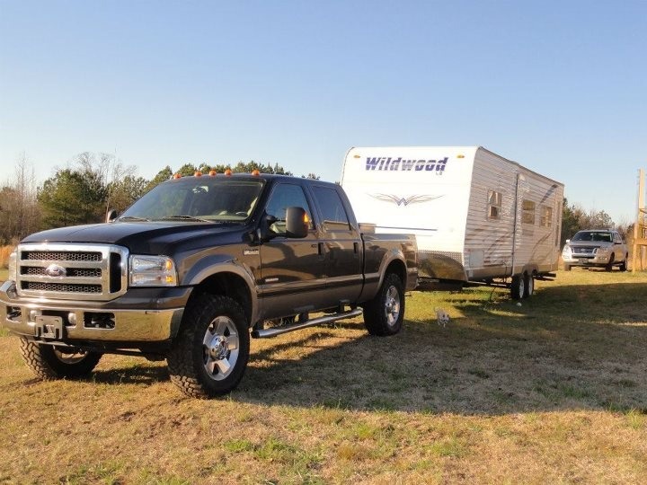

295/65/20 nitto trail grapplers on stock 20s. Measure 35.4" tall and 12.3" wide. 2" Daystar leveling spacer. No rubbing.
