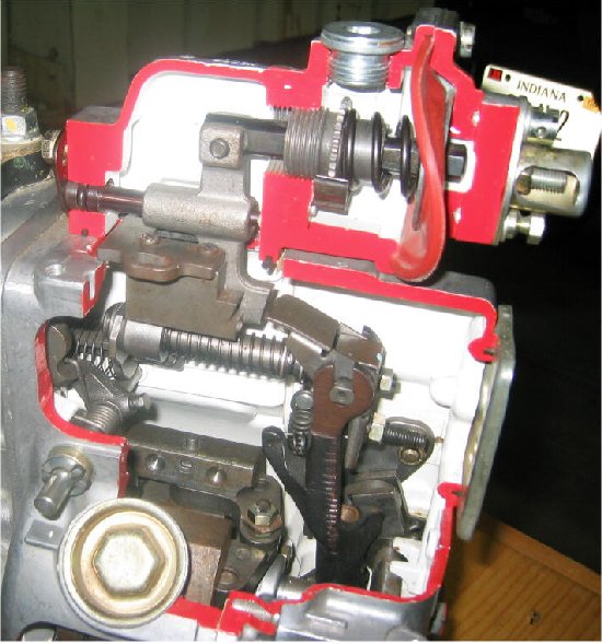

The rack plug wont do anything at all unless your AFC is modded for full travel. It will bind before it goes all the way. Take the afc off and work on it off the truck, you can check things easier that way. You can get a goos starting point by setting it shop air.

was just about the say that to,
there is a few right ups over on comp d.
if i remeber right most people do these,
pull the afc all the way apart
shave a little off the end of the "foot" (the part the shaft slides into inside the afc housing, NOT the part that goes down into the pump)
flip the washers on the rubber diaphram and shave the lips off them (or replace them with fender washers of the same size)
then just spend time using regulated shop air hooked into the back of the afc to adjust the starwheel and preboost "smoke" screw (very back, under the little nipple cover that has 2 screws holding it on) to set it up to start moving at desired boost you want.

Then today I started tuning the pump becuase I couldnt take it being so slow any more. I modded the AFC for full travel, adjusted the starwheel for full fuel at 40psi of boost and cut the fuel plate to a #100 and set it at full forward. Took it out for a test drive and made a huge difference. Pulls a whole lot harder now and went from hitting 35psi max to 50psi now, and it gets there quick. And itll do burnouts now LOL
The big downside is it gets hot quick, at 50 psi it has the 1600 degree pyro pegged and its wayyyy to smoky under no boost going from a dead stop or cruising so I think tomorrow Ill start by backing off the preboost screw and then maybe moving the fuel plate to the middle and possibly bump timing to 24*. Just needs more tuning but its making progress

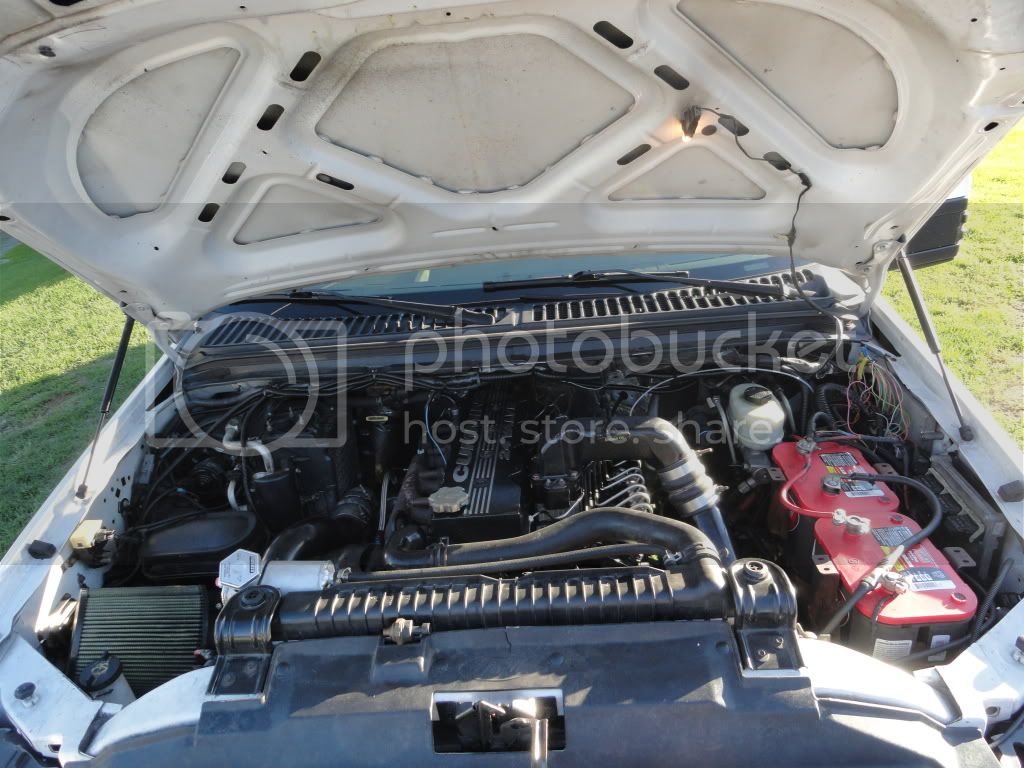

Well the slowness was getting old but now that Im getting the pump tuned in its a whole lot more fun to drive. Only thing is I need to start looking for a metal end tank 7.3 IC cause I dont see this plastic end tank one lasting long at 50psi

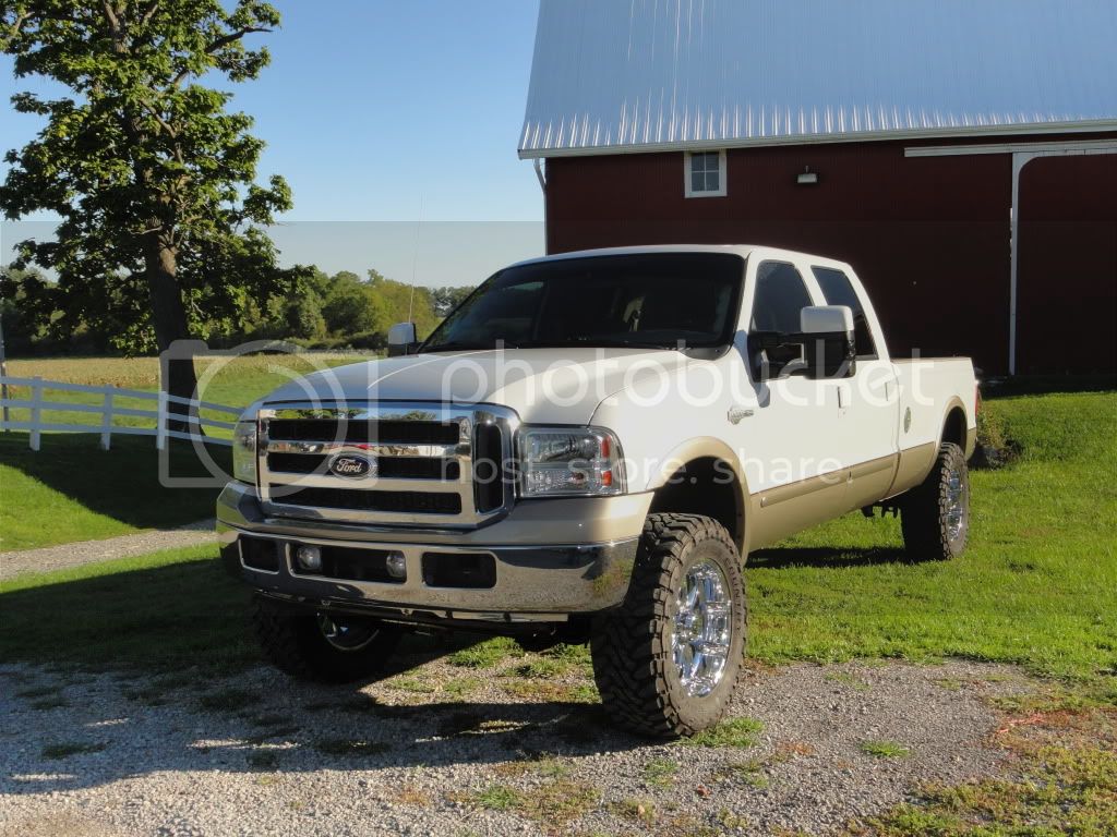

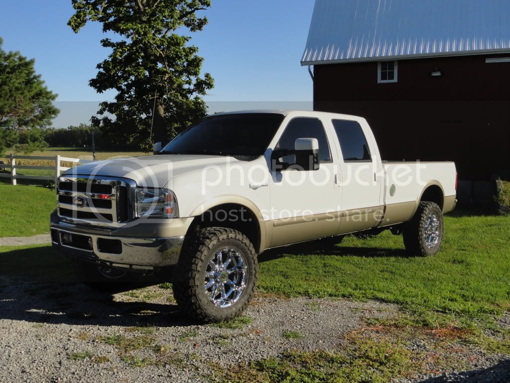

Updated pictures, Almost 1000 miles on it now:
