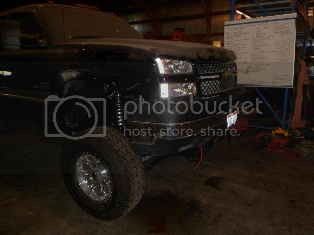

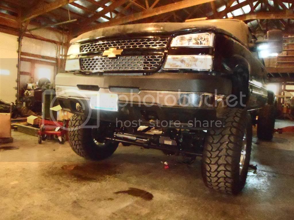

Yeah..... I painted all the junk behind the grill flat black and built a new workbench for the shop - the bench will eventually be a transmission building table.... but for now its the perfect height to stand on and work under the hood! LOL

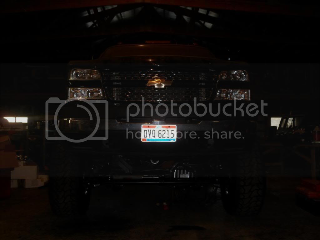

Mocked up the bumper, grill and headlights for the first time at the end of the day - pretty sure I'm going to be real happy with this with just a few more tweaks :D

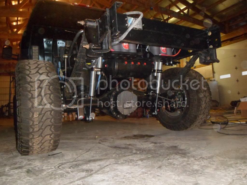

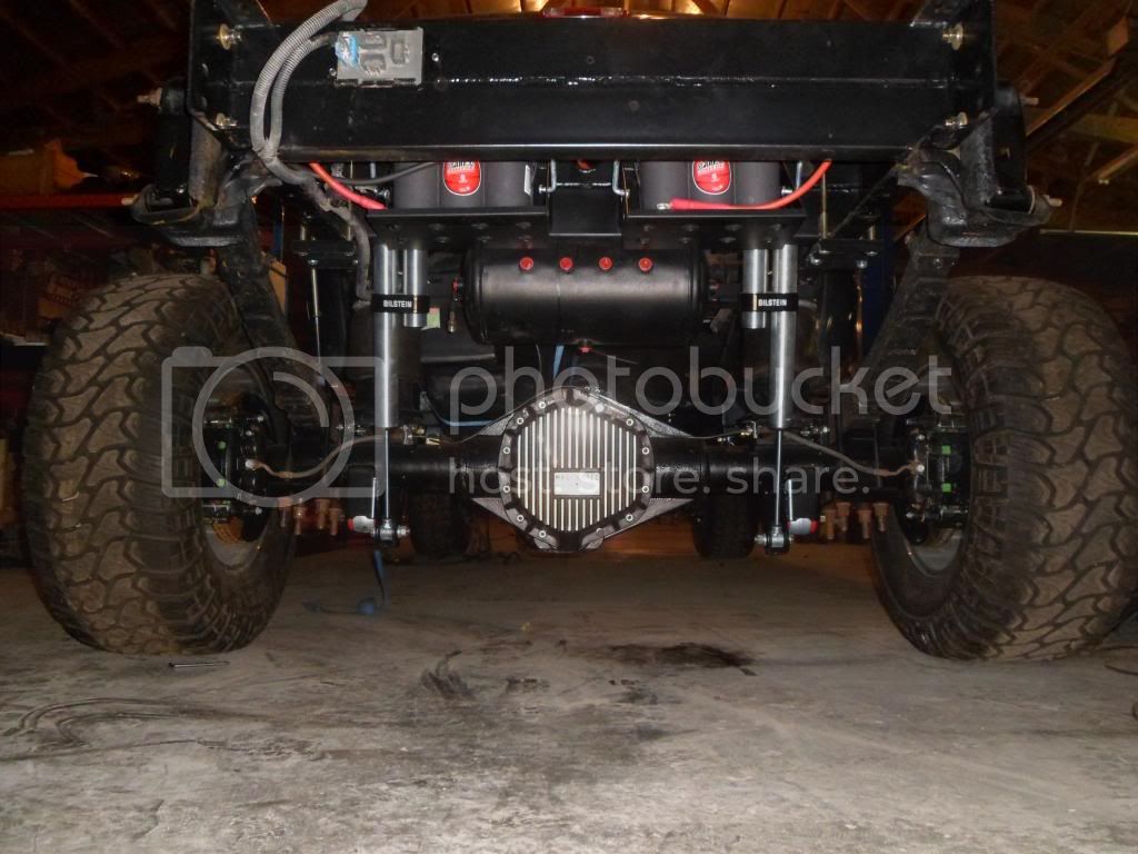

Assembled rear rolling stock:
What air bags are those?

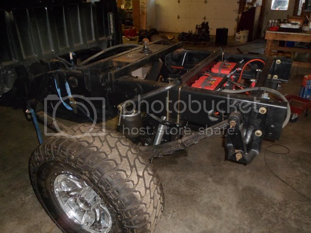

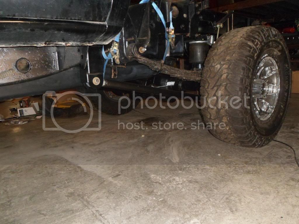

I like how u made that sway bar set up... is that home made or a kit? Looks like the project is finally coming along.! It looks mean as hell
That is a modified kit - I wasn't sure how it was all going to work out - but if I had to start over I would have built the sway bar setup using some race car parts so it was tunable. My front sway bar is made up of race car parts - I just don't have it installed yet. I bought a "kit" for the front that was intended to work with this SAS - but some of the other options I have interfered with things - so I I opted to piece something together for the front - basically its a shaft with splines on each end and then a pair of flat bars with splines - I can adjust the length of the flat bars as well as the construction of the splined bar to change how it reacts.

They are a Firestone bag - same ones used in the Cognito long travel bag kits and very similar to the ones found on the front end of some freight shakers.
Would it be hard to find the part number? Looking for a set of bags for my truck but don't want to limit travel. Thanks
