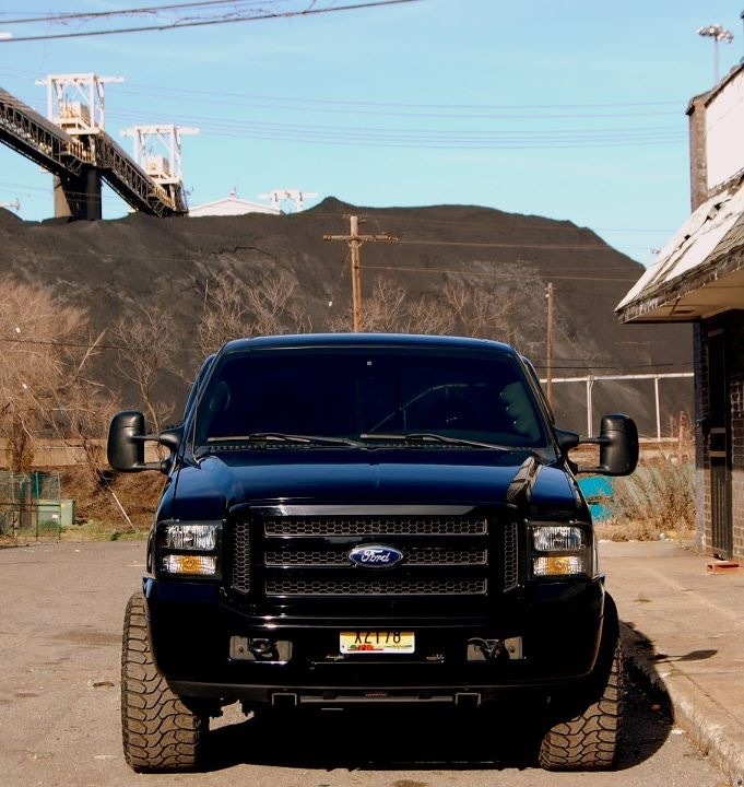

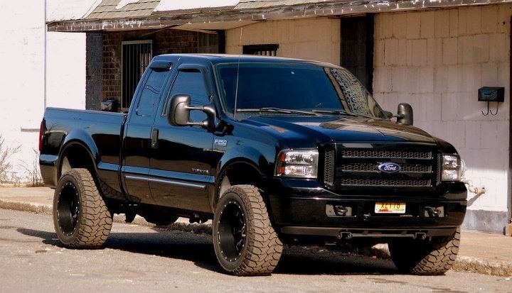

Jeremy I have to say i love the way ur truck looks. It makes me want to go back down to stock and get wider tires and rims. Very nice job. I wish i could see it in person. Like they say black is beautiful.
20x12 fuel throttles. 325/50/20 Mickey Thompson atz.
2000 f250 with 07 front end. Completely stock suspension.
Good bit of rubbing left front inner fender liner. Cut about 5-6 inches off to ensure no rubbing. Right fender liner almost never rubs except on uneven ground and at full lock.
I should add that the tires stick out 2-3 inches past the fenders.

This set-up would look awesome on yours the height that it is at now. They would actually stick out a inch further on each side due to 05+ trucks having a wider axle width.

I wish i could have those tires. I had two choices when i did mine expensive rims or tires. I went with rims. Im right at NJs limit for tire sticking out and im pushing it with these tires. But i still kick myself everytime i see his truck. To me that is the down right killer look. Especially since its black.

:whs: WV doesn't care how wide.. but everytime I see his it makes me hate the fact I went 10 wide in those wheels.
